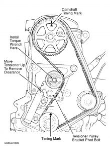

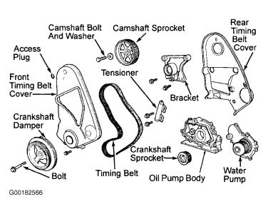

Water pump is driven by the timing belt
https://images.2carpros.com/forum/automotive_pictures/99387_Graphic1_210.jpg
https://images.2carpros.com/forum/automotive_pictures/99387_Graphic2_99.jpg
