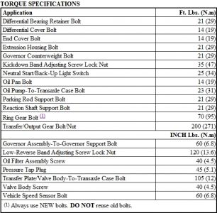

Can you tell me what the Torque should be for the Output Shaft Housing. I am about to replace the bearing and seal.
Thank You.
David

Now I am told it is the Transaxle Extension Housing cover. I need the torq for the 4 bolts that hold the cover. The Output Shaft bearing is being replaced.

the list above contains all torque specs needed for overhauling your vehicle's transmission. the extension housing bolt is listed 4th down on the list.. 21 Ft. Lbs.
