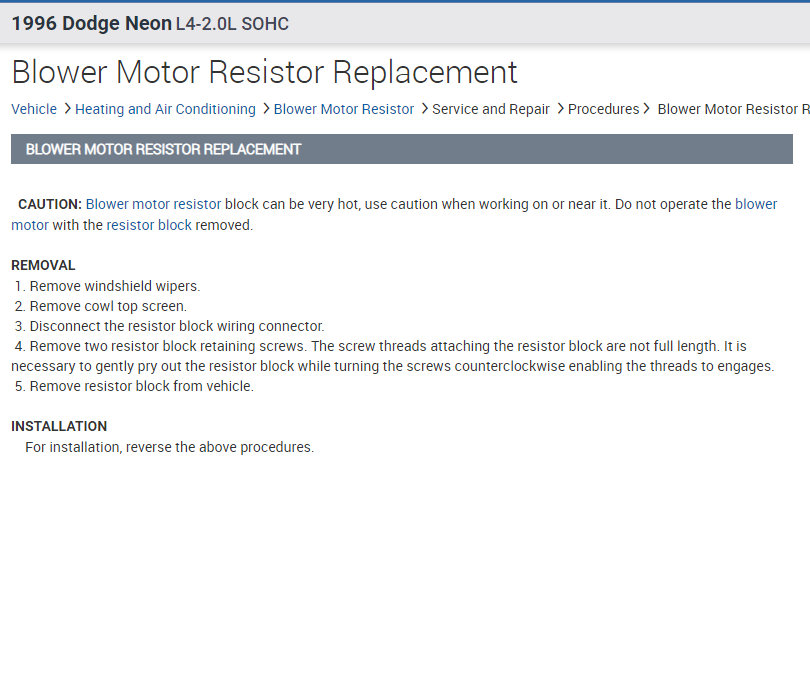

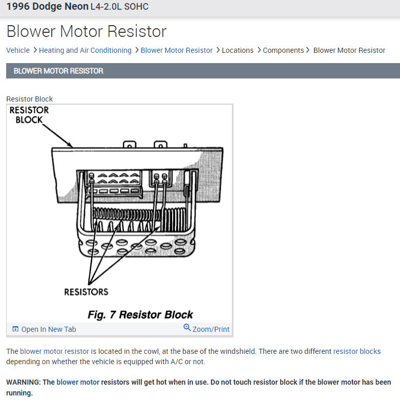

Another possibility is a issue with the blower motor resistor.

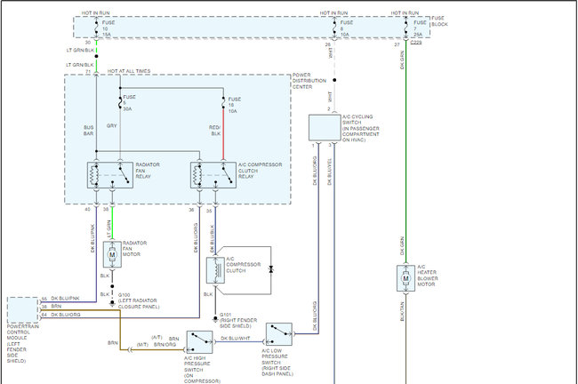

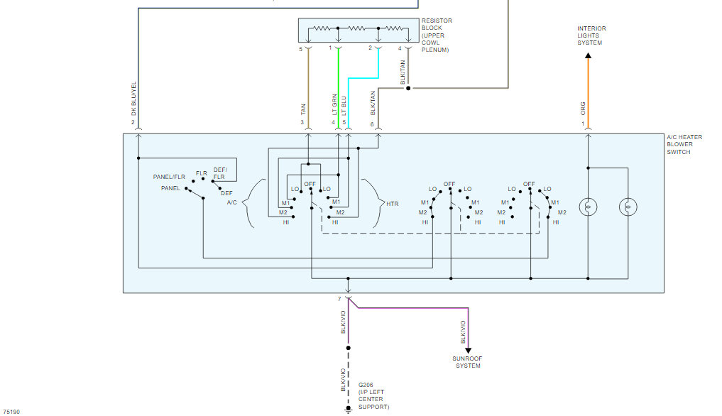

I have attached the wiring schematics for your reference.
