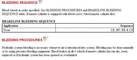

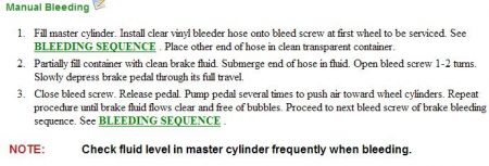

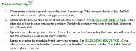

1996 Plymouth Neon 6 cyl Front Wheel Drive Manual na miles
IS THERE AN ORDOER YOU HAVE TO BLEED THE BRAKES IN I HAVE REPLACED BOTH FRONT CALIPERS I AM IN THE PROCESS OF BLEEDIN HOW EVER THE PASSINGER SIDE IS NOT DOIN ANYTHING

https://images.2carpros.com/forum/automotive_pictures/261618_Noname_848.jpg
https://images.2carpros.com/forum/automotive_pictures/261618_Noname2_223.jpg
https://images.2carpros.com/forum/automotive_pictures/261618_Noname3_80.jpg
