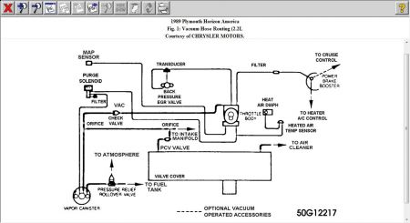

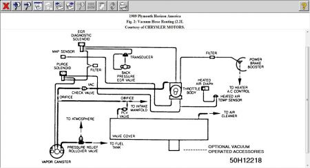

need a diagram for where all vaccum lines go bought old car that sat for years restoring with my uncle but all the line were rotten so bad they fell apart ,to repeat i beg you to find me a detail diagram where all vaccum lines for a 1989 plymouth horizon 2.2 liter engine
Apr 29, 2009 at 6:49 AM
  • 75,988 POSTS
There you go fast leaner 2.2L Federal
https://images.2carpros.com/forum/automotive_pictures/12900_vac1_2.jpg
2.2L California
https://images.2carpros.com/forum/automotive_pictures/12900_vac2_3.jpg
