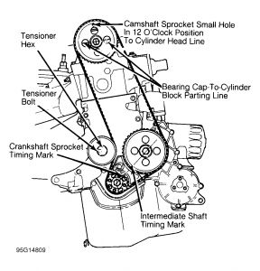

How do I align the shafts when replacing the belt? I can eyeball it of course, but I'd much rather use pins or something of that sort.

hI THERE, Timing marks as per pic Mark (mhpautos)
https://images.2carpros.com/forum/automotive_pictures/61395_PLYM_1.jpg
