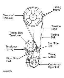

Engine Performance problem
1991 Plymouth Colt 1.5L engine 4 cyl Front Wheel Drive Automatic n/a miles

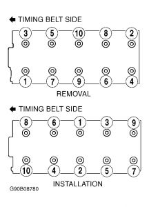

Need a diagram showing where to set the timing and head bolt torque specs

Will need engine size in Liters for correct info.... it is either a 1.5L or a 1.6L.

.[/quote:f2a7ae14a9] its a 1.5L sorry forgot to type it in.

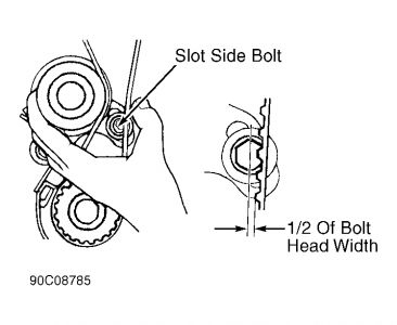

Torque specs and a diagram for how to set timing belt would be greatly appreciated
Feb 7, 2009 at 1:21 PM
OBXAUTOMEDIC
  • 3,711 POSTS
I also added the timing tensioner adjustment...
https://images.2carpros.com/forum/automotive_pictures/188069_91colttimingmarks15L_1.jpg
https://images.2carpros.com/forum/automotive_pictures/188069_91colttimingtensionadjust15L_1.jpg
https://images.2carpros.com/forum/automotive_pictures/188069_91coltheadboltpatern15L_1.jpg

Torq Specs - 53 Ft lbs in 2 -3 stages. Does not specify exact stages just as long as the last stage it 53 ft lbs.
