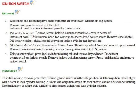

How to remove key ignation?

https://images.2carpros.com/forum/automotive_pictures/261618_Noname_1773.jpg
