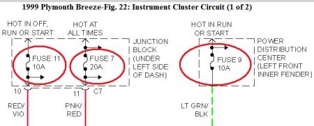

1999 Plymouth Breeze speedometer
1999 PLYMOUTH BREEZE
BETTYBETTYBJA
1999 Plymouth Breeze 6 cyl Two Wheel Drive Automatic
it stop woking do you have a guess what could be the broblem

Start by checking these 3 fuses. If they are good, remove the cluster from the dash, and check all connectors. I suspect bad cluster.
