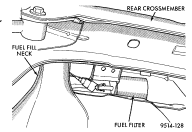

Where is the fuel filter located?

Fuel Lines at Fuel Pump Module
Fuel Filter
The fuel filter mounts to the frame above the rear of the fuel tank. The inlet and outlet tubes are permanently attached to the filter.
