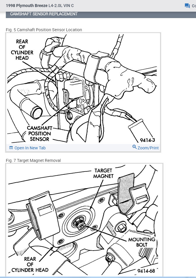

Where is the camshaft position sensor located?
Monday, June 14th, 2010 AT 10:35 AM
15 Replies
INTERNETMECHANIC
  • 700 POSTS
It should be on the end of cylinder head.
https://www.2carpros.com/forum/automotive_pictures/512072_plymouth_breeze_1.jpg

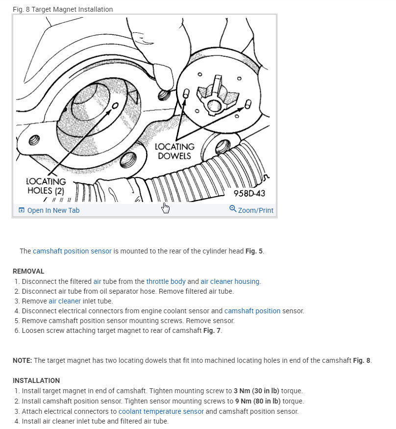

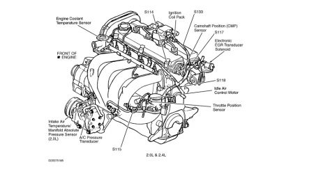

Location and replacement.
Thursday, November 26th, 2020 AT 12:56 PM (Merged)
Hi SonyDime,
Attached is the procedure that shows the location as well. Let me know if you need more information. Check out the diagrams (Below). Please let us know if you need anything else to get the problem fixed. Thanks

CMP sensor can be also used to synchronize the injectors. And identifies the firing sequence of the cylinders.
You have a crankshaft position sensor have them check that out-its located on right front side of engine block.
