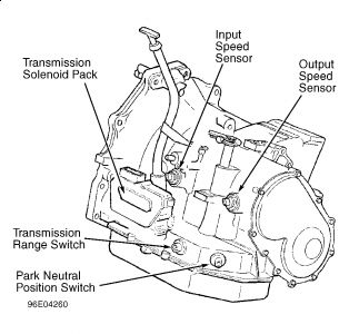

cycle key on off on off on get the codes let me know what you have for codes most common is tranny solenoid and or speed sensors similar to this
https://images.2carpros.com/forum/automotive_pictures/99387_Graphic9_20.jpg
