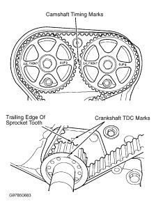

Hi, Just replaced my water pump/Timing belt on my 98 plymouth breeze 2.4L DOHC. Thought I aligned timing marks correct on intake/exhaust sprockets & crankshaft TDC marks, but has a rough idle,wants to stall when you take foot off gas when driving, but has plenty of power at all higher speeds.
Also, checked for vacuum leaks & replace a couple of hoses, thinking the marks still might be off a smidge, but not sure. Thank you, Keith
Jul 15, 2010 at 5:00 AM
  • 75,992 POSTS
If you put the no.1 piston on its compression/TDC and line everything up as seen below Disconnecting the battery can throw off the idle air control valve its probably going thru a relearning process.
https://images.2carpros.com/forum/automotive_pictures/12900_timing_36.jpg

Thank you, I will take into consideration, this rough Idle only started after changing belt, 1st & 2nd attempt of lining up timing marks caused the engine to not start & backfired. 3rd attempt, the engine started and drives good, but now idles rough.
What are your thoughts on timing marks being slightly off, can car have plenty of power & still have a rough idle? Almost like a misfire...
It is my understanding this set up for this engine is very difficult because of the way the engineers designed the location of the marks on the teeth.

The only way to find out is to open it back up-try checking the ignition timing if its correct
