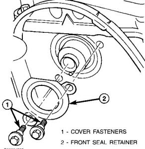

I replace the head gasket on my car in June of 2006. I am leaking oil again. I took it to a mechanic and he said that he sees where the head has been replaced and that it looks like the oil is coming from the head. Upon researching, I found out that the oil could possibly be coming from a leaking valve cover gasket. Could that be the case? I live in Bronx, NY. I have driven this car to Georgia and Boston and back. I never had a problem. Could it be the valve cover gasket? The replaced head isn't even 2 years old.

You should get a good look at the cam position sensor as it is often mis-interpreted for a head gasket leak. Also a suspect would be a cam seal. There is a retainer that may have not been put on that may allow the seal to push out.
https://images.2carpros.com/forum/automotive_pictures/30961_acamsea_1.jpg
The first thing to check is going to be the pcv system to be sure it isn't plugged as it will allow a pressure build up inside the motor to force leaks.
