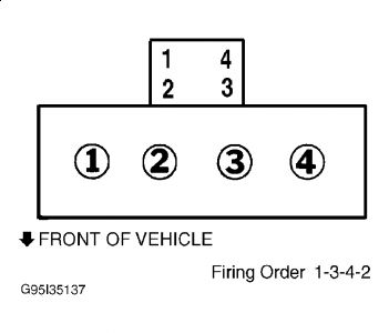

can I get some help with the firing odere for a plymouth breeze

https://images.2carpros.com/forum/automotive_pictures/55316_98breezefiring_1.jpg
