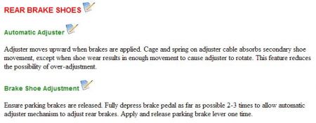

Are the rear brakes self adjustable?
Jan 30, 2010 at 7:23 AM
BLUELIGHTNIN6
  • 16,542 POSTS
Yes..
https://images.2carpros.com/forum/automotive_pictures/261618_Noname_1553.jpg
