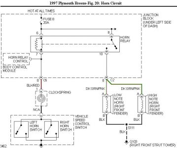

The horn on my car is constantly going off while i'm driving. Easy fix during the day by just removing the fuse, but at night, its a whole different story, since my parking light are also affected by the removal of the fuse. I try hitting on the horn to try to depress it, but it seems that the more i hit on it, the worst it gets.

Hello, my first thought, is a problem with the wiring harness in the steering column. I don't have wiring info for your horn, but, the horn button or switch is usually just a ground. There should be a horn relay, don't have the location.
I do have a power distribution wiring diagram, it just shows voltage to the horn relay, doesn't show how the horn itself is wired. For the relay location, it just says junction box, I don't think that will help. You might just unplug the horns, not the relay, until you can find the problem. I don't know what else to tell you?

Here you go.
https://images.2carpros.com/forum/automotive_pictures/55316_97breezehorn_1.jpg

Thanks, good information.
