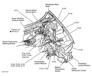

Where are the cooling fan relays located?
Cannot find them as labeled in the PDC.

Hi there, Both relays are located in the power distribution center see pic. mark (mhpautos)
https://images.2carpros.com/forum/automotive_pictures/61395_Graphic_18.jpg

Thanks for your response but I did not find the cooling fan (2 - low speed and hi speed) relays in the Power Distribution Center.
After a little looking I found a smaller unmarked "black box" hiding behind the positive
battery post and just under the resonator assembler that houses 4 relays. Two of these relays are for the control of the two radiator cooling fan.
