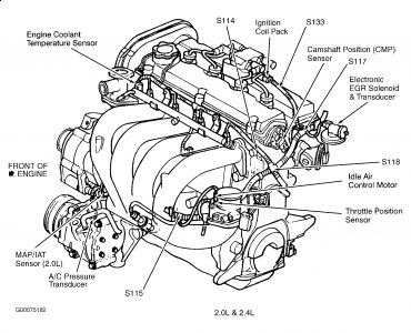

Where is the coolant sensor located on the breeze
Aug 1, 2009 at 10:14 AM
  • 110,244 POSTS
It's on the front of the engine. Here is a picture for the location of the 2.0L and the 2.4L 4 cylender.
