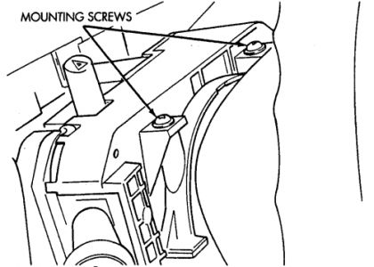

I HAVE NO POWER TO REAR OF CAR NO BRAKE LIGHTS OR TURN SIGNALS OR RUNNING LIGHTS OR BACKUP LIGHTS[/quote]
Feb 1, 2010 at 7:01 PM
MATHIASO
  • 1,209 POSTS

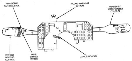

Hello larzo65 The entire switch assembly must be replaced.
https://images.2carpros.com/forum/automotive_pictures/46384_0900c15280089b61_1.jpg
Remove the steering column lower cover retaining screws. Loosen the lower section of the instrument cluster hood for clearance, as necessary. Remove the steering column upper cover.
https://images.2carpros.com/forum/automotive_pictures/46384_0900c15280089b62_1.jpg
