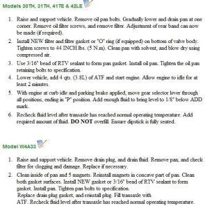

How do i change my transmission filter is it the same as the one you have on the site or would it be different

https://images.2carpros.com/forum/automotive_pictures/261618_Noname_2338.jpg
