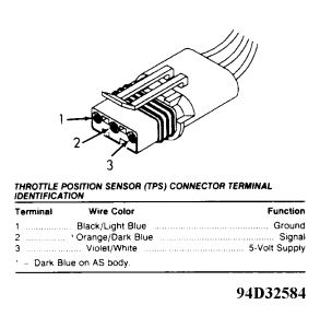

The throttle positioning sensor like you had said during idle and unpluggin made no differance ,. However when probing it I get an on or off . no variation in voltage . and it just spikes at 12 volts then down to zero . then to 12 and back to zero .

Something is wrong here !! 5 volts should be and no more at idle it should be less then 1volt and as you increases the throttle volts should go up no more then 5 volts are u sure you are testing the TPS and if so you should have a check engine light with a TPS code cycle key on off on off on off on with in 5 sec check engine light blink codes (* ** code 12 ***** ***** code 55 ) and so on check the TPS harness and plug

Your right the TPS is functioning correctly .
