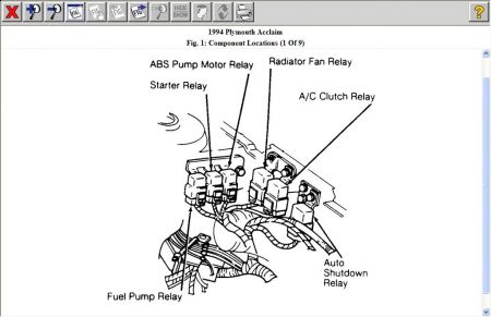

were is the realy at on this car the pump is not working no gas geting to engine need to find realy to see if thats it first before taking pump off car and puting a new one on
