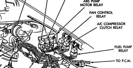

car turned off on me, doesnt seem like any gas is reaching the engine, I would like to check the location of the fuel pump relay, but I'm not sure where it is. Also the Fuel pump cant find any information on if it is outside the tank or somewhere else, can you help me with that?

Welcome to the forum, the fuel pump relay shows to be under the hood, driver side fender lining. The fuel pump is in the gas tank. I'd also check trouble codes, see if there are any
https://images.2carpros.com/forum/automotive_pictures/170934_acclaim_fuel_pump_relay_1.jpg
