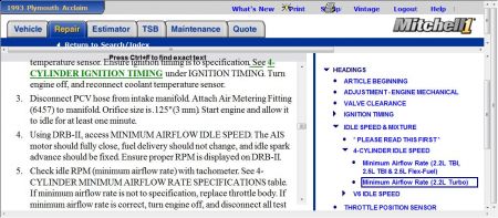

i have a 1993 plymouth acclaim 4cyl the idle is kind of low i dont know where to raise it and i noticed the throttle cable is very loose im afraid its gonna come off the guider on the throttle body is there a way to tighten this and could that be why the idle is low i have performed all scheduled maintanence for this car timing,fuel filter,cap,roter,wires,plugs,all belts,water pump, thermostat,trans service etc
Mar 19, 2009 at 4:10 PM
  • 75,992 POSTS

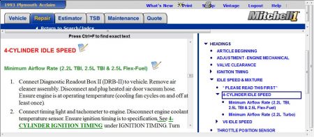

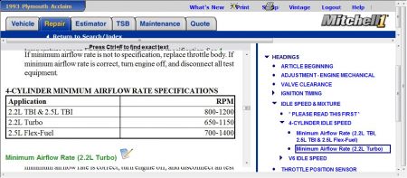

You need to fix whatever is loose could be affecting the idle speed and also see below for adjustment
