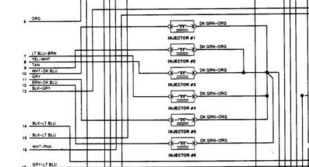

1993 Plymouth Acclaim 6 cyl Automatic

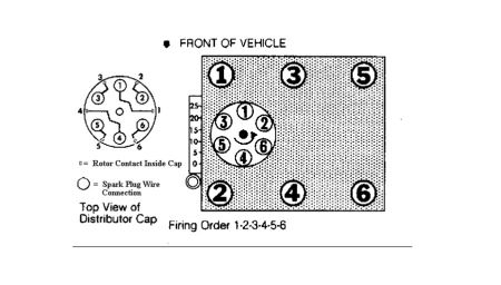

I need a diagram of the order the fuel injector plugs are supposed be attached. Every time I've hooked them up I can only get 4 of the 6 to fire, and every time I change the order of the injector plugs it changes witch ones fire.

I'd check voltage to injectors, first, engine cranking. You might do an ohms test on all injectors, compare readings, everything off. Any applicable mil codes? Injector 1 is cylinder 1 and so on. The info I looked at was 3.0L.
https://images.2carpros.com/forum/automotive_pictures/170934_plymouth_acclaim_injectors_1.jpg
https://images.2carpros.com/forum/automotive_pictures/170934_acclaim_firing_order_1.jpg
