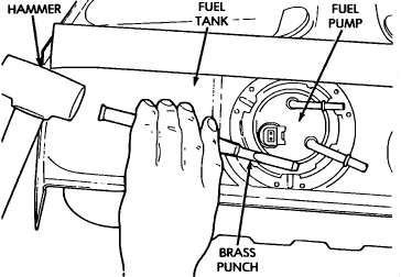

where is the fuel pump?
Wednesday, July 28th, 2010 AT 12:48 AM
MECHANIC
75,992 POSTS
Removing Fuel Pump
The fuel pump mounts inside the fuel tank, and the fuel tank must be lowered to access the fuel pump.
