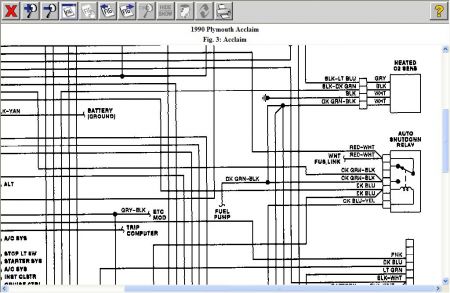

Where is the fuel pump relay located
Saturday, May 10th, 2008 AT 1:50 PM
MECHANIC
75,992 POSTS
You don't have a fuel pump relay -The ASD relay powers the fuel pump thru the dark green and black wire see below
