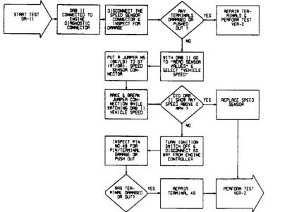

I get trouble code 15 which states that no distance sensor signal is detected during road load conditions. How do I test the distance sensor? Thanks.

Hello Thanks for the donation Below are the first steps in checking your vehicle's VSS (vehicle speed sensor AKA distance sensor)..
https://images.2carpros.com/forum/automotive_pictures/261618_Noname_468.jpg
Let me know what happens and I will continue with troubleshooting procedures.. Thanks for using 2CarPros.com!
