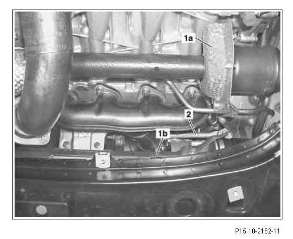

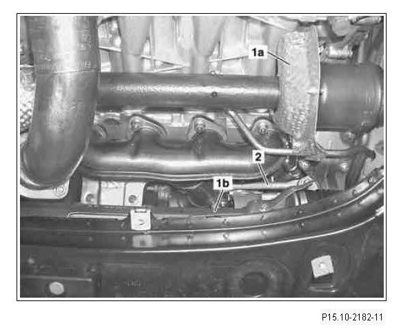

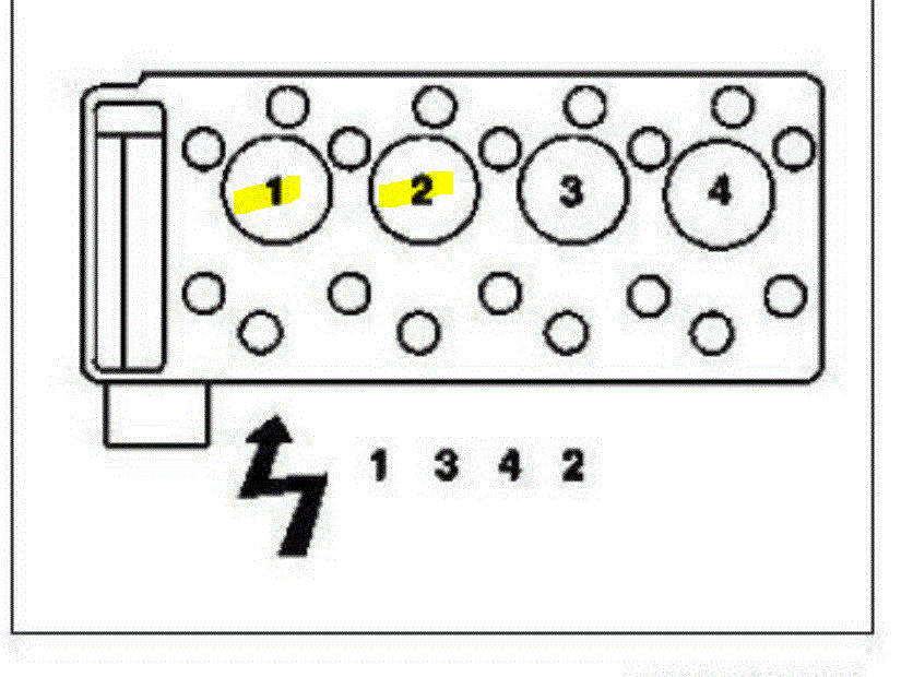

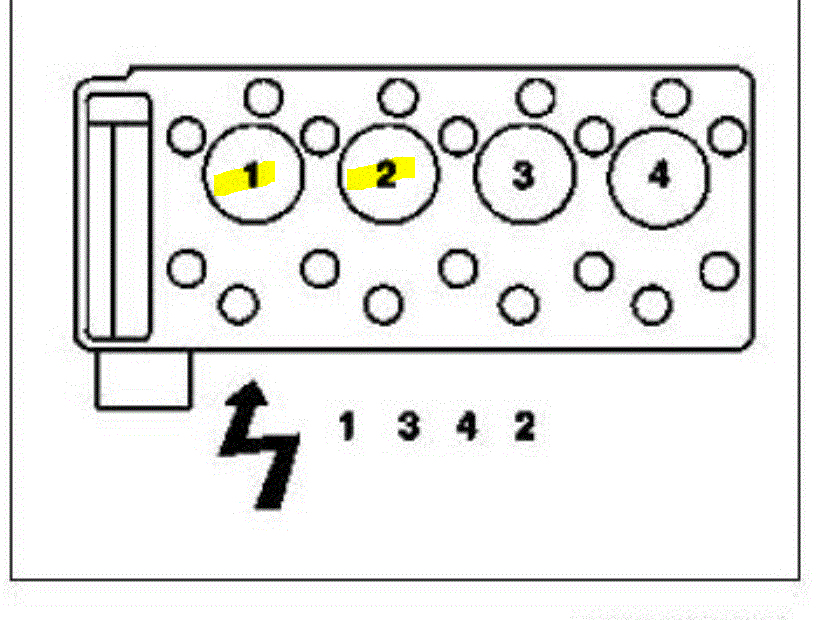

Please i like to get a guide on how to replace plugs on cylinder number 1 and 2. also if i need a special key for the plugs.

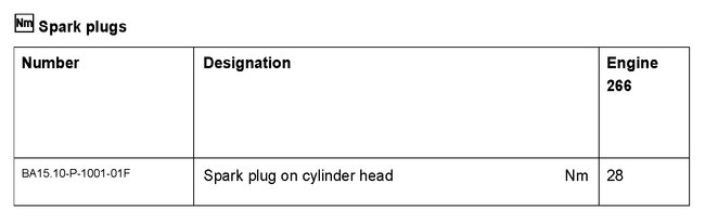

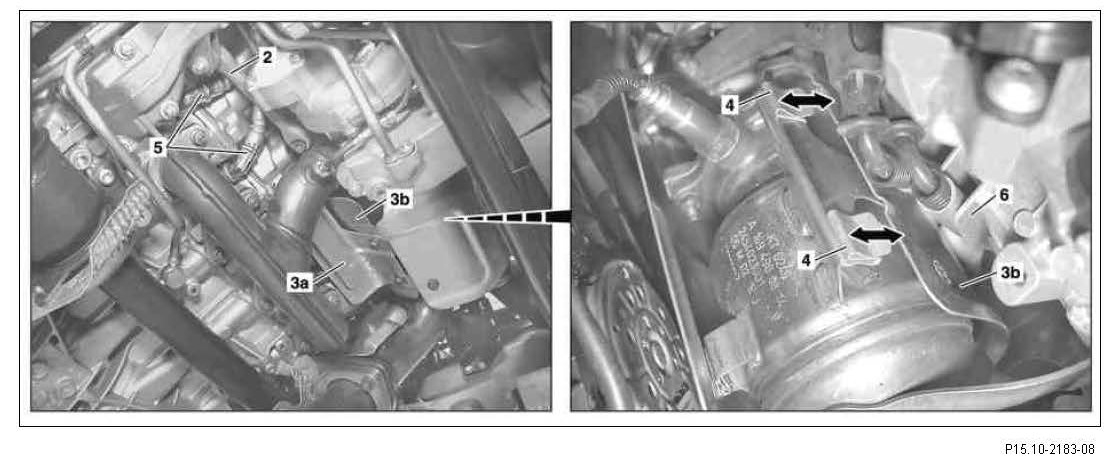

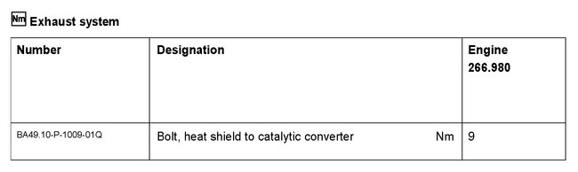

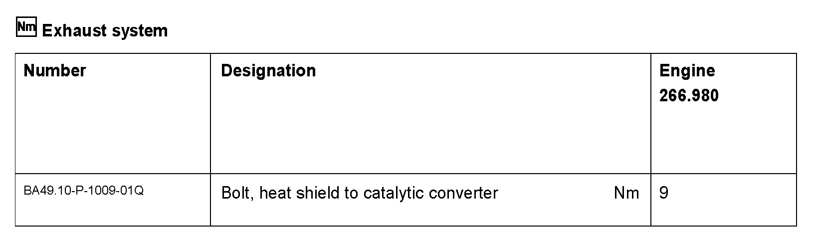

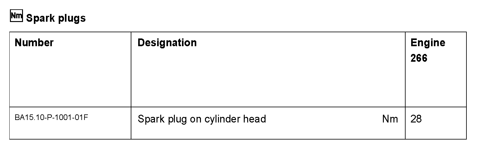

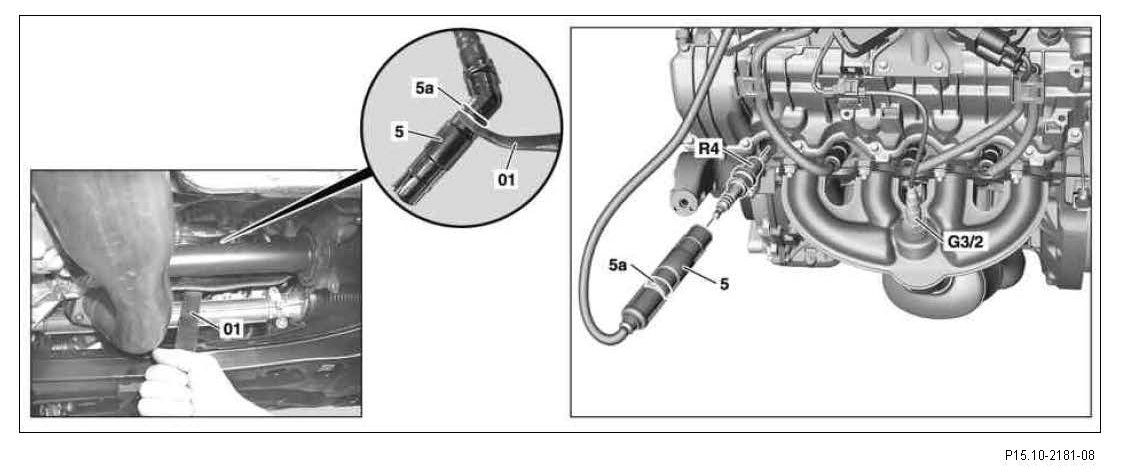

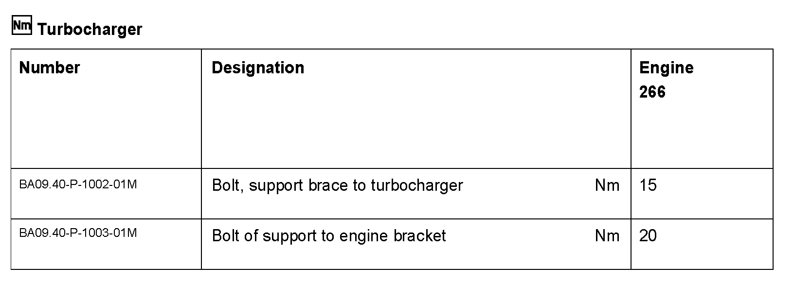

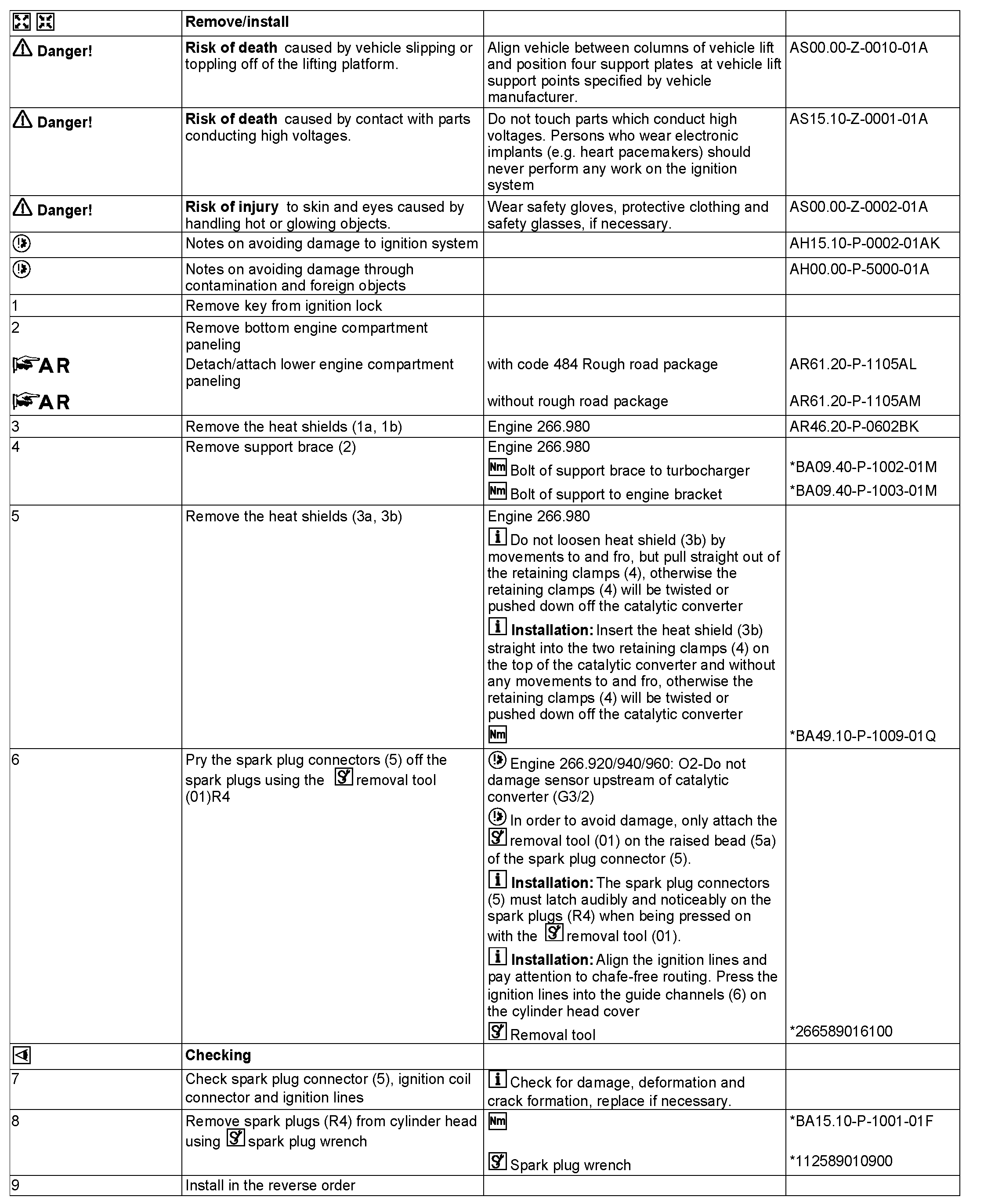

Here are the directions specific to your vehicle. I would recommend replacing all of the spark plugs at one time. The attached pics correlate with the directions.
_______________________________
2006 Mercedes Benz B 200 (245.233) (CANADA) L4-2.0L (266.960)
AP15.10-P-1580AK Replace Spark Plugs
Vehicle Powertrain Management Ignition System Spark Plug Service and Repair Removal and Replacement AP15.10-P-1580AK Replace Spark Plugs
AP15.10-P-1580AK REPLACE SPARK PLUGS
ENGINES 266.920 in MODEL 169.031 /331, 245.231
ENGINES 266.940 in MODEL 169.032 /332, 245.232
ENGINES 266.960 in MODEL 169.033 /333, 245.233
ENGINES 266.980 in MODEL 169.034 /334, 245.234
pic 1
Illustrated on model 169.032
01 Removal tool
5 Spark plug connector
5a Ridge
G3/2 O2 sensor upstream TWC
R4 Spark plugs
pic 2
Illustrated on model 245.234
1a, 1b Heat shield
2 Support brace
pic 3
2 Support brace
3a, 3b Heat shield
4 Retaining clamp
6 Guide channel
pic 4
pic 5
pic 6
pic 7
pic 8
266 589 01 61 00, Removal tool
pic 9
112 589 01 09 00, Spark plug wrench
pic 10

If you only want to replace cyl 1 and 2 plugs, the last pic identifies the location.
