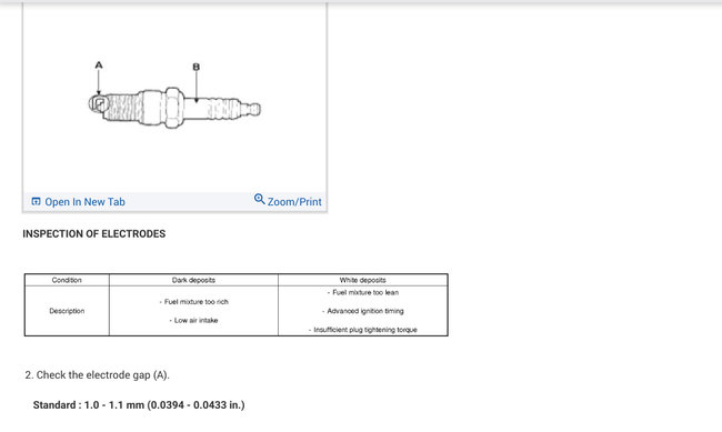

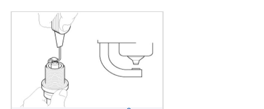

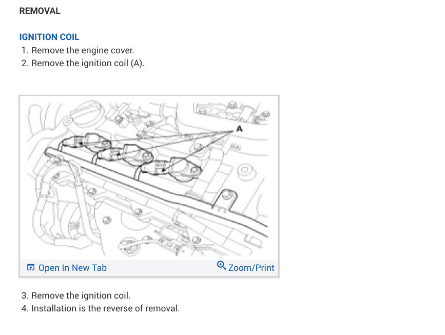

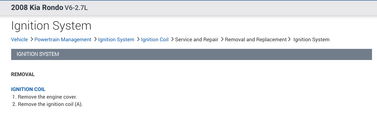

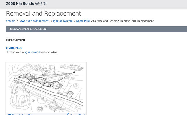

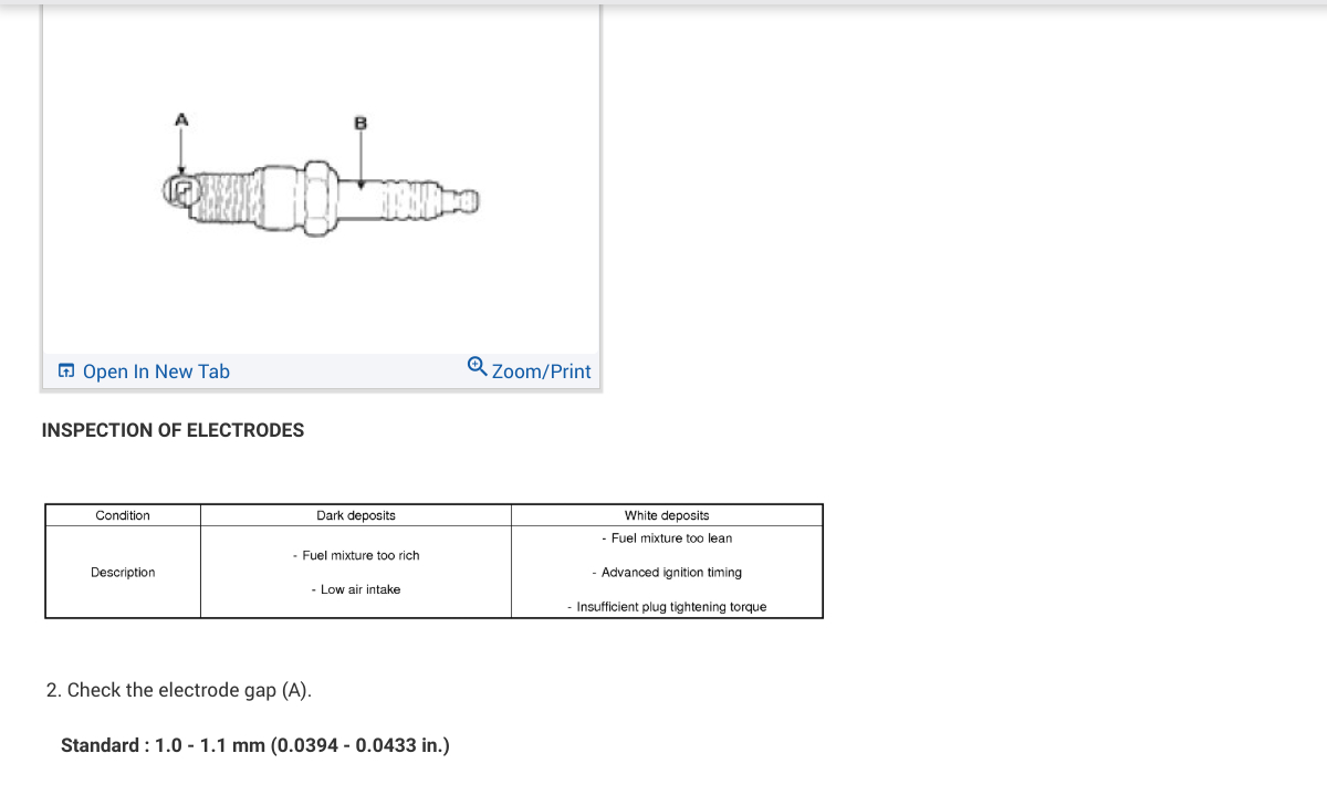

Need to change all 6 plugs and coils how to?
Dec 23, 2019 at 4:30 PM
SCGRANTURISMO
  • 4,897 POSTS
I have included the information that you requested, instructions for the removal and installation of the ignition coils and spark plugs for your vehicle, in the diagrams down below. Please go through these guides and get back to us with how everything turns out.
