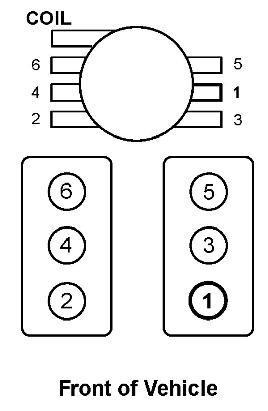

Somehow messed up when replacing plug wires, terrible miss and knocks. The cap has numbers, but I need a diagram to see what is run to wrong place.
Oct 13, 2024 at 6:53 AM
  • 55,433 POSTS
Sure here is the engine firing order and spark plug numbers, just match them up and you should be good to go.
Firing Order .................... 1-6-5-4-3-2
