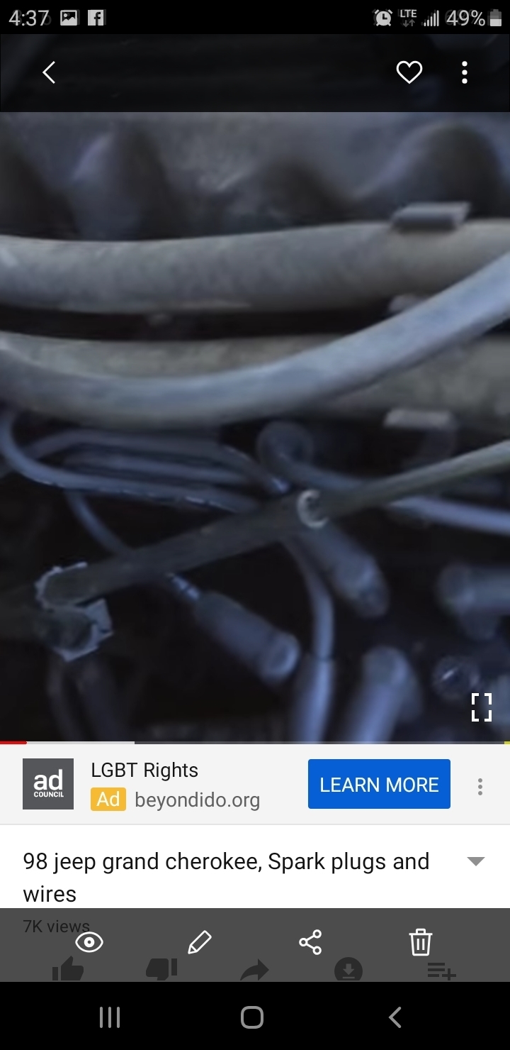

Plug wires have two different ends, cannot figure out where they go. Some of the ends are straight and some are curved.

I sent a picture of what it looks like maybe you can tell me if it looks right.

Nothing came through.
Can you try again?
Thursday, August 8th, 2019 AT 1:47 PM
MALCORN
MEMBER
5 POSTS

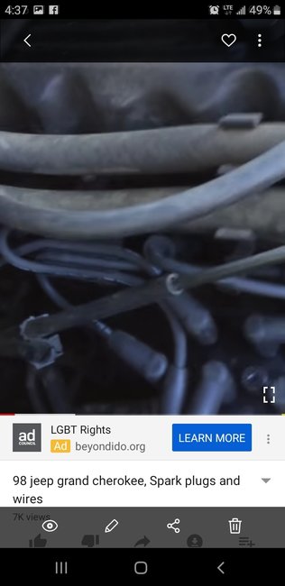

I resent it.
Images (Click to make bigger)
Thursday, August 8th, 2019 AT 1:57 PM
MECHANIC
52,797 POSTS
They look okay. I can only see the center wires.

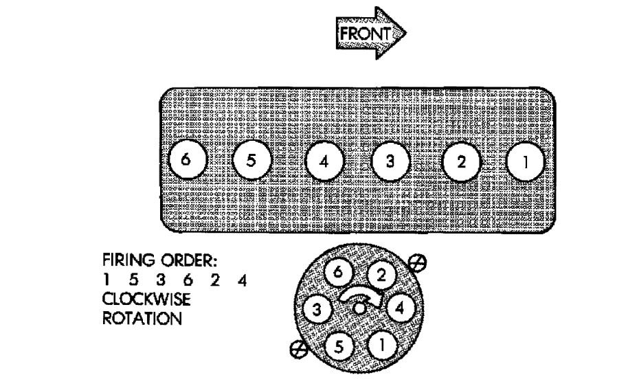

Can you send me pic of what they should look like
Thursday, August 8th, 2019 AT 2:08 PM
MECHANIC
52,797 POSTS
There is no picture of the wires installed in any manuals.
When you replace the wires, you should do them one by one matching length and the ends.

Meant diagram. And I did just dont know how I messed up was trying to put distributor in also and somehow got them mixed up
Thursday, August 8th, 2019 AT 2:18 PM
MECHANIC
52,797 POSTS
Diagram of wires and firing order.
Image (Click to make bigger)
