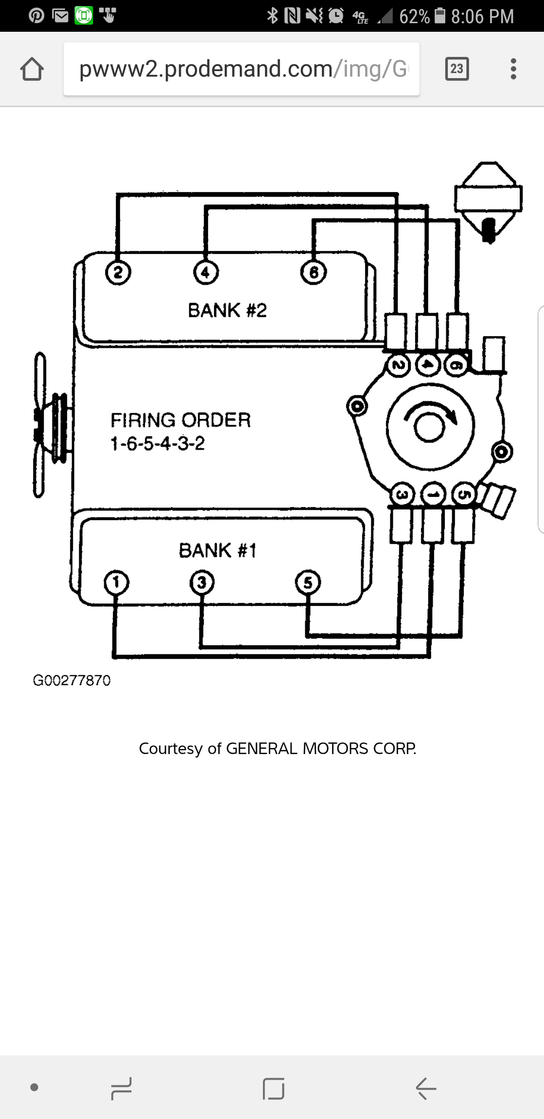

Plug wire diagram
2004 CHEVROLET EXPRESS
200,000 MILES • 4.3L • 6 CYL • 2WD • AUTOMATIC
SHAWNWISEMAN2014
Wire location from distributor cap to cylinders.

There is the diagram you requested. we are here to help. Here is the location in the diagrams below. Please let us know if you need anything else to fix it. Check out the diagrams (Below). Please let us know if you need anything else to get the problem fixed.
