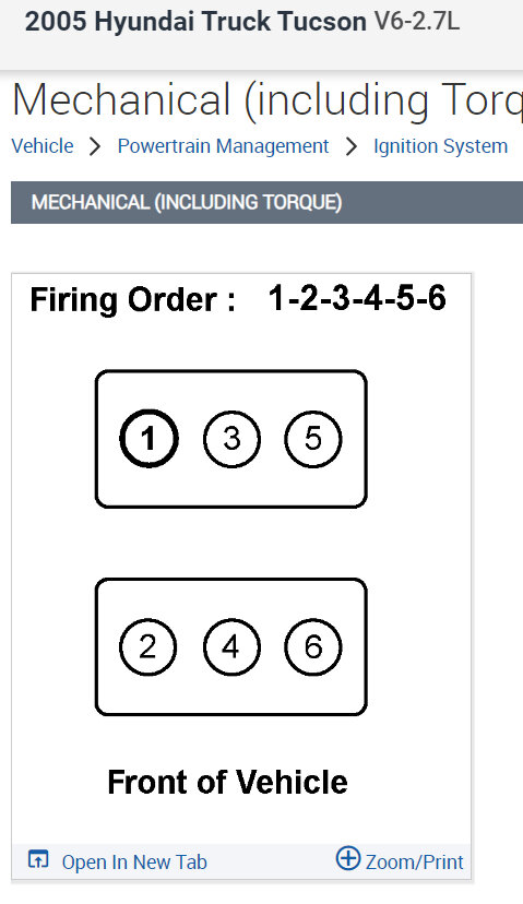

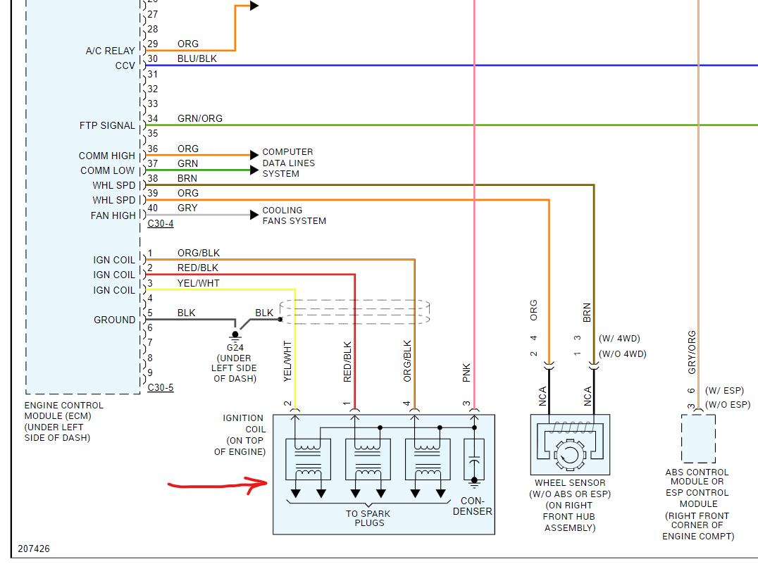

I need a picture of the order of plug wire to coil the order on coil.
Sep 19, 2024 at 9:04 AM
Experienced Mechanic
55,676 POSTS
Sure, here is the ignition coil wiring and the ignition system firing order. Check out the images (below). Let us know if you need anything else.
