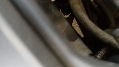

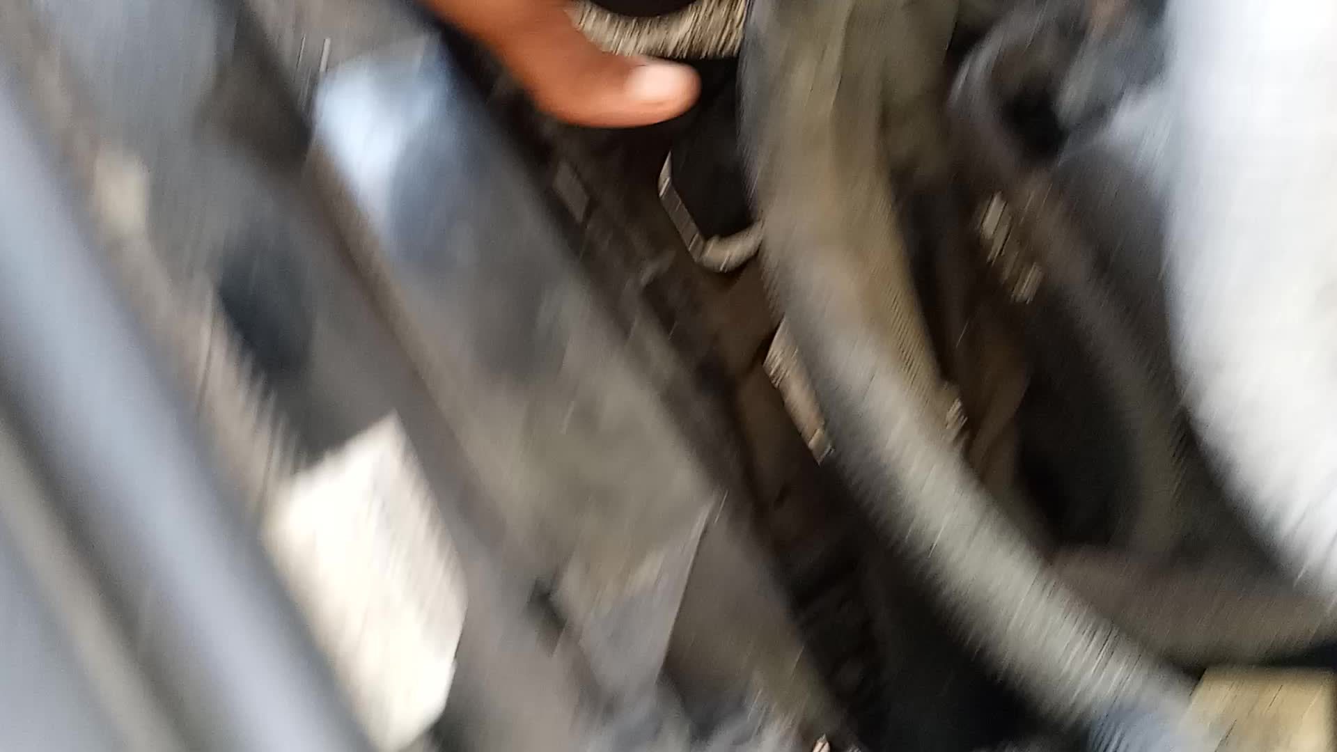

It's a 2012 Buick Lacrosse I uploaded a video of the wire.

You mentioned that the fans do not come on. Do both of the fans have wire connectors attached to them?
Also, can you tell me the wire colors that are on that connector?
Aug 14, 2022 at 2:32 PM
TJEREMY2235
Yes, both fans have wire connectors. And the colors on the connector there's a green wire. One looks black and yellow. And the other one has a red strip I'm not sure of the other color on the wire looks like it's a see-through color. And only 3 wires.

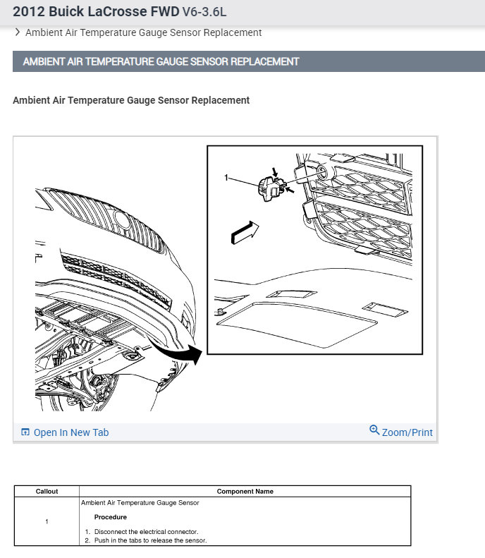

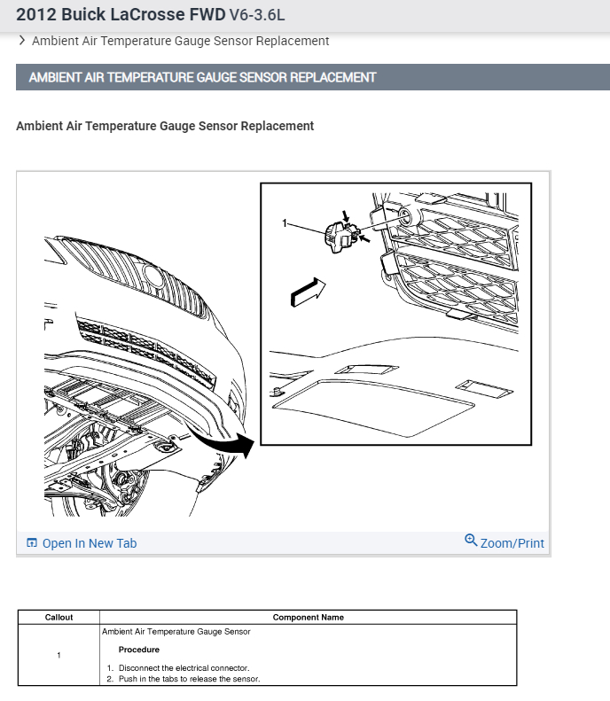

This could be the outside temperature sensor harness.
See diagram below.
Aug 17, 2022 at 10:44 AM

Would that not being plugged in cause the fans not to turn on?
Aug 18, 2022 at 6:57 PM
SQM
  • 6,383 POSTS
That should not impact the fan performance.
Have you tested the fans by providing 12V power to them?
