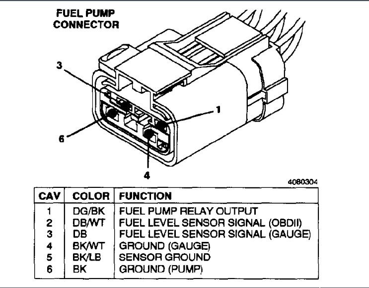

Fuel pump wiring harness plug.
Thursday, April 30th, 2020 AT 4:52 AM
MECHANIC
52,796 POSTS
Good morning,
I attached the plug from the body to the pump assembly. It contains wire colors, location and functions.
What is the issue?
