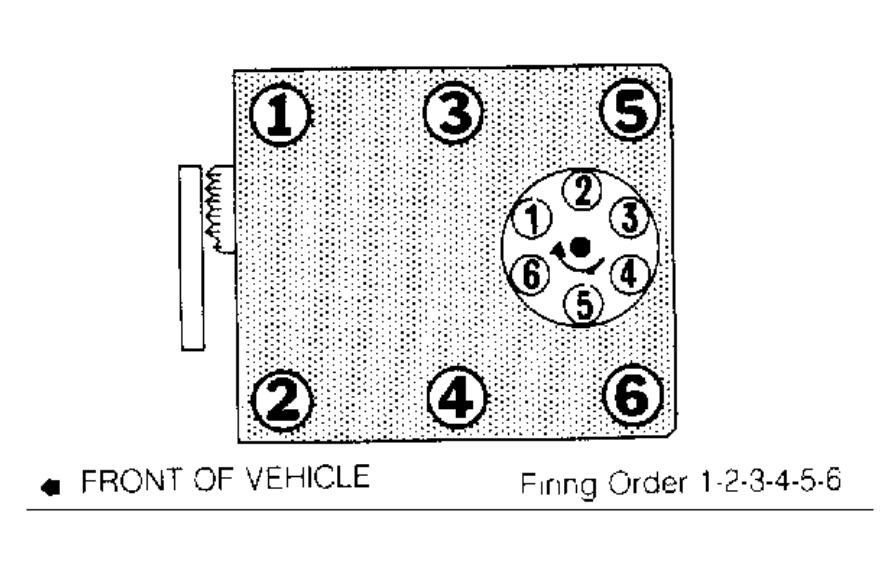

Please show #1 clynder location on Eng AND #1 location on Dis send photo to make copy

see pic
