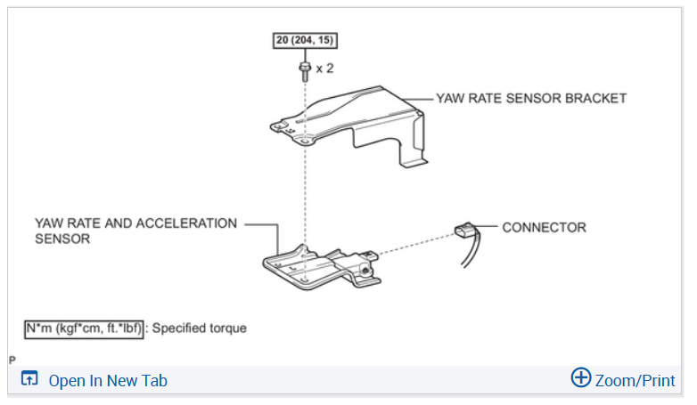

Code C1244 open or short circuit in deceleration sensor?
2009 TOYOTA COROLLA
5 MILES
LEKMAN32
c1244 open or short circuit in deceleration sensor?
Apr 7, 2025 at 11:30 AM
  • 55,433 POSTS
This sensor is also called a Yaw sensor.
C1244 – Yaw Rate Sensor Zero Point Calibration Not Performed
This sensor is under one of the front seats, I would check the electrical connector for corrosion as well before replacing the sensor. Check out the images (below). Please let us know what happens.
