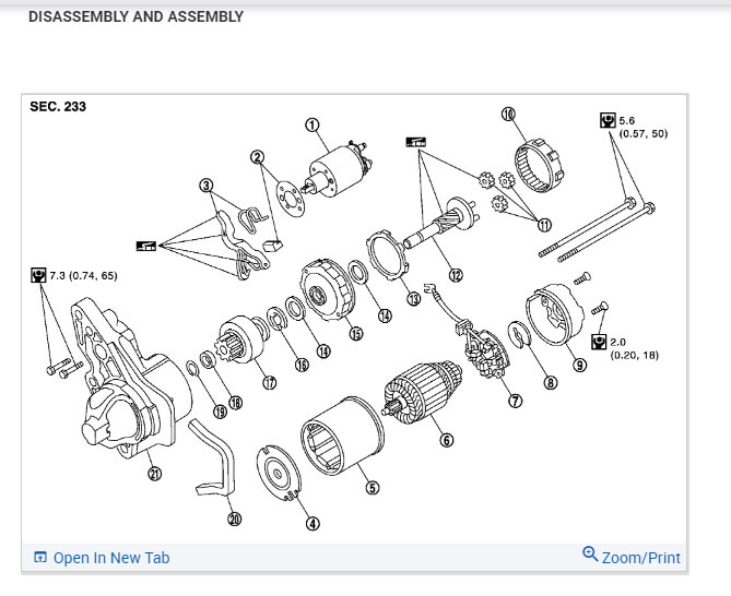

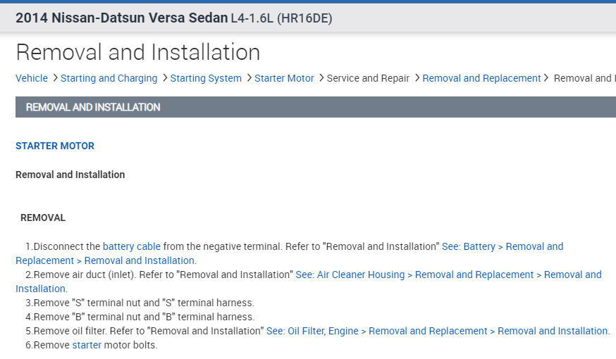

As far as the starter motor is concerned, all I have is an exploded view of the component. Pic 1 is the exploded view of the starter motor and pic 2 is the legend of parts.

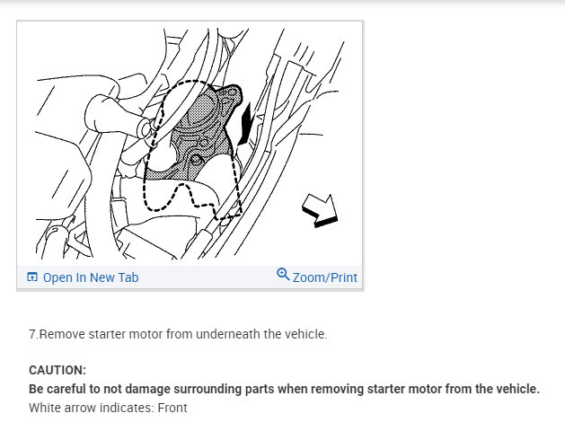

As far as draining the coolant, no that isn't necessary. You will, however, need to remove the oil filter and air inlet tube.

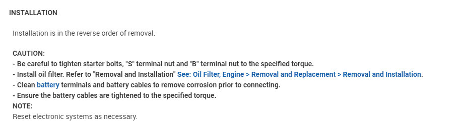

The last three pics are the directions for the removal and replacement of the starter motor specific to this vehicle.

Thank you technician Joe, from the diagram or schematic it looks like it's a permanent magnet starter motor because I don't see any field windings around the electromagnetic poles, it has carbon brushes but older type starter motors had only two carbon brushes on the commutator, this starter motor has multiple carbon brushes which are less likely to fail, now can I please switch to the alternator? is it okay to ask about the alternator or do I need to initiate and verify a new question starting all over again? all right is the vehicle listed above SV mode current-producing device an alternating current alternator or a direct current generator? I am asking because I don't see an integral voltage regulator in the back of this thing, I just see two wires coming out of the back but no integral voltage regulator and also in the back of this device I don't see a cover that would hold the rectifier assembly's three positive and three negative diodes with the rectifier's diodes being the electrical components that switch alternating current to usable direct current or useable direct current to operate the electrical and electronic accessories, and how much does it cost to replace this alternator or generator device? I saw in the Advance Auto Parts website that an alternator or generator device for a 2014 Nissan Versa SV sells for well over $300 dollars and I don't know how many hours labor does it take to replace it, in my original post above I mentioned that before the vehicle listed above SV mode I had a 2000 Kia Sephia and that Kia Sephia took $300 dollars to replace its generator in both parts and labor but the vehicle listed above SV mode's generator or alternator sells for over $300 dollars for the part alone at the Advance Auto Parts store and a repair shop would have to mark it up to make a profit on it so is $600 dollars enough for parts and labor as I see that access to the generator or alternator is relatively easy, you just remove the serpentine belt to access it, and finally I forgot to ask how long does this alternator or generator last? it now has 85,000 miles on it but the 1990 Ford Taurus we once had, its alternator lasted less than 50,000 miles, thank you in advance for your helpful and valuable information technician Joe.

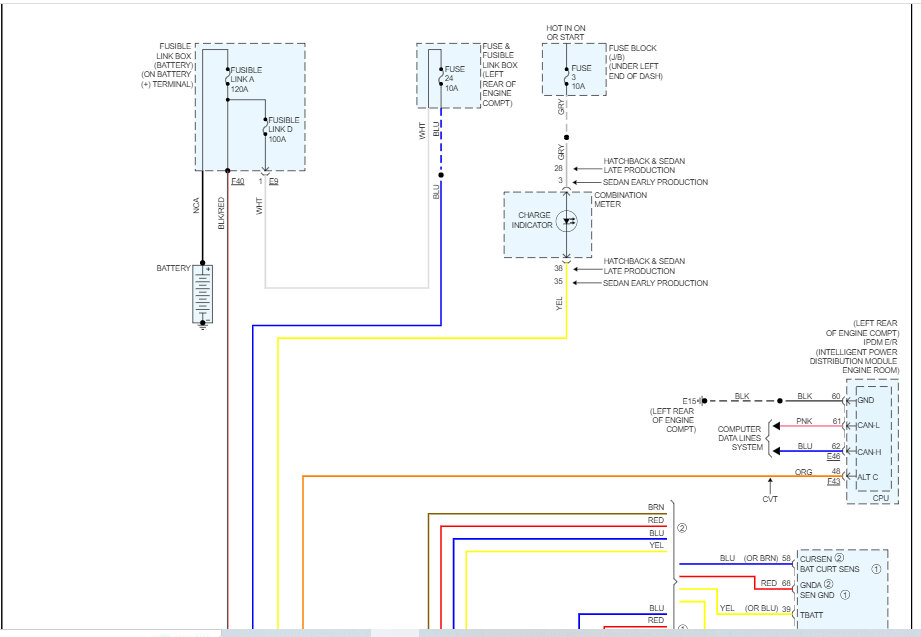

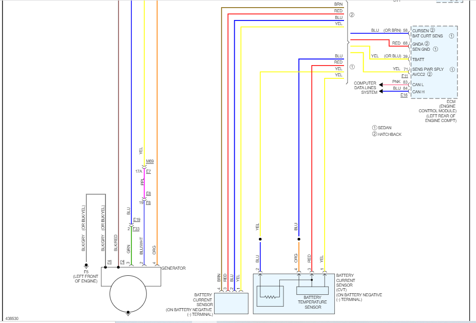

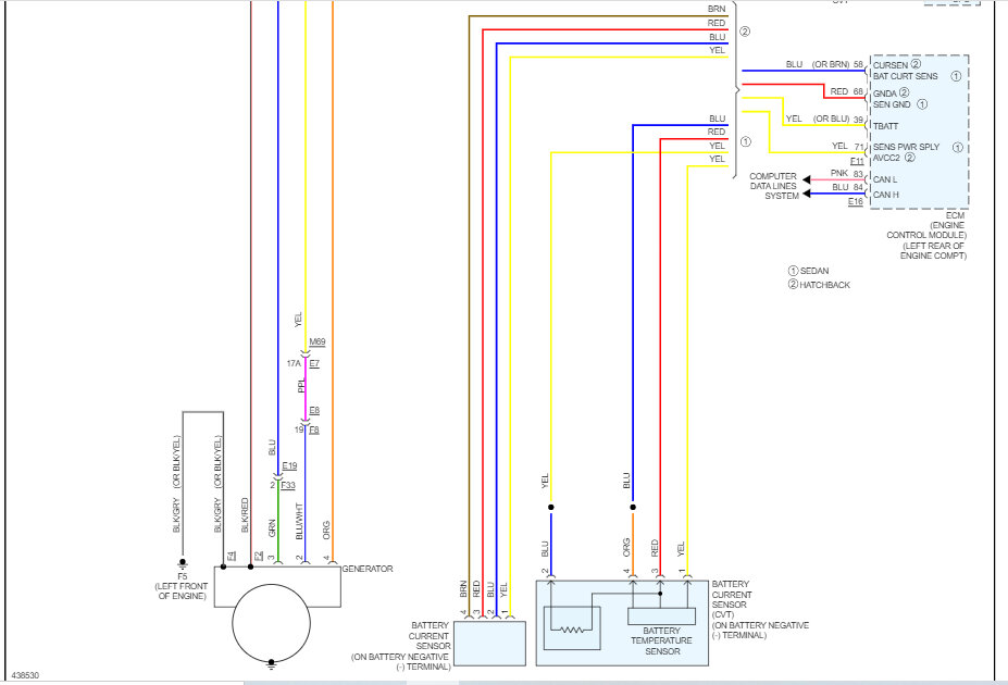

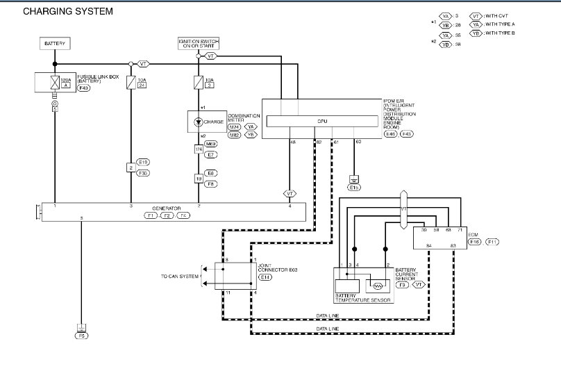

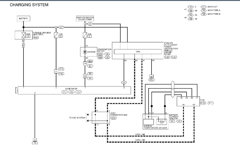

The regulator is internal with the alternator. If you look below, I attached the wiring schematic that you may find helpful. Also, as far as the life expectancy of an alternator varies. My wife's Durango now has 125K on it with no power issues. Actually, the original battery from 2013 is still in the vehicle and has made it most recently through below 0 temperatures.
Although the life is variable, I would expect one to last at least 100,000 miles.
Let me know if this helps.

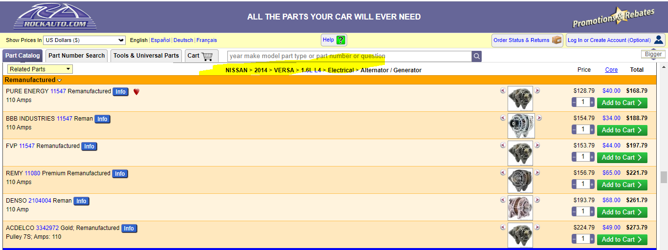

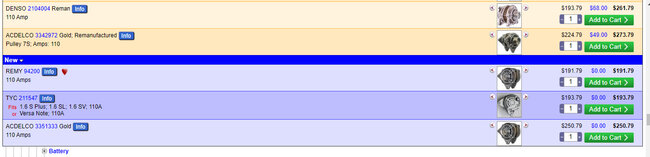

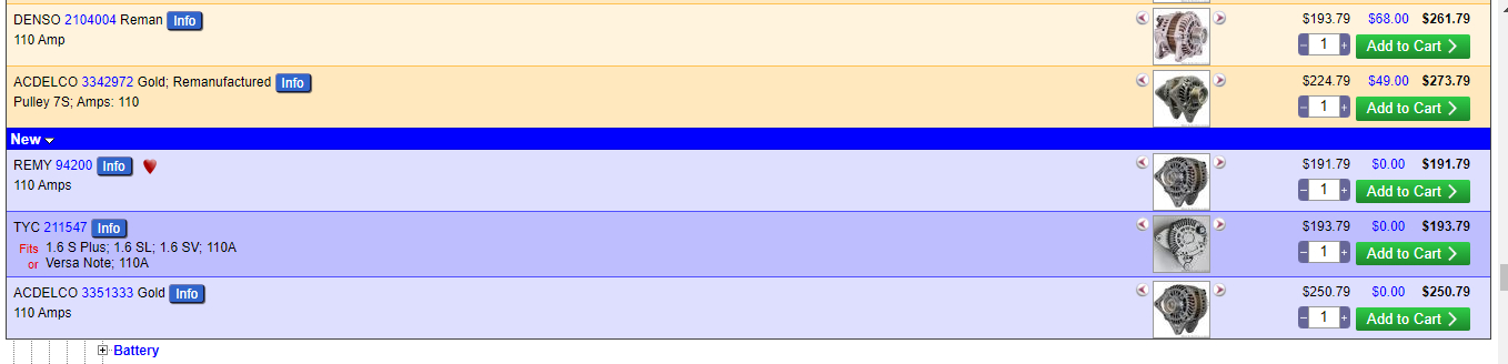

See pic below. Note: Pics 1 and 2 are from the same page. I cut them in half to make them readable. Pic is the manufacturer's schematic. Pics 4 and 5 are from Rockauto.com with prices for alternators. You may want to check them out. If you decide to get one, let me know and I'll get you a discount code for an additional 5% off.

Wow, Rockauto.com alternators are much cheaper than Advance Auto Parts and the Rockauto.com website has a variety of so many different alternators all of them miraculously cheaper than $300 dollars while all those alternators that Advance Auto Parts supplies are way above $300 dollars and Advance Auto Parts slams you with a core charge, the electrical schematic calls the charging device a generator instead of an alternator and I don't see diodes or a rectifier assembly in the electrical schematic, Wow, the 2013 Dodge Durango is very dependable because in the 1990 Ford Taurus we once had a long time ago the alternator and battery kept going out once every single year, and its original alternator only lasted less than 50,000 miles before it discharged the battery. Thank you very much technician Joe for sharing all that information with me. written by Alex Stathas
