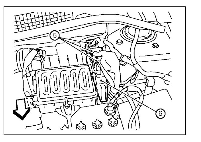

Multiple codes?
2007 NISSAN MICRA
160,059 MILES • 4 CYL • MANUAL
STACELS
P1122 ETC FUNCTION/CIRC Electric Throttle Control Performance Problem
P1121 ETC ACTR- Electric Throttle Control Actuator
P0107 ABSL PRES SEN/CIRC Manifold Absolute Pressure/Barometric Pressure Circuit Low Input
P0223 TP SEN 1/CIRC Throttle Position Sensor/Switch 2 Circuit High Input
P0123 TP SEN/CIRCUIT Throttle Position Sensor/Switch '1' Circuit High Input
P0335 CKP-SEN/CIRCUIT Crankshaft Position Sensor Circuit
P0340 CMP SEN/CIRC-B1- IT Camshaft Position Sensor Circuit Bank 1
U1001 CAN COMM CIRCUIT 1T IPDM E/R Invalid or Missing Data for Primary Id

I would clear the codes and then turn the key on without trying to start the engine. Then run the codes and if all or most come back I would replace the PCM #6. Check out the images (below). Please let us know what happens.
