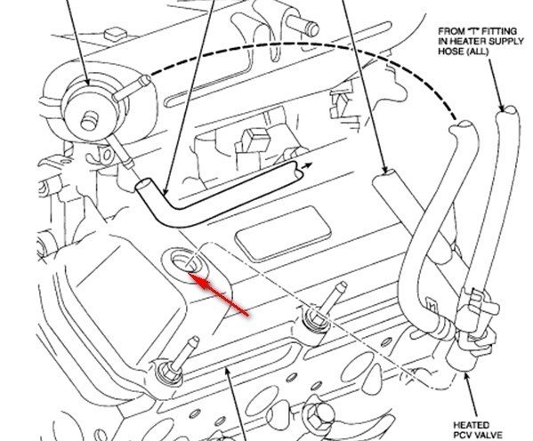

I need to get some clarification. Coolant is coming from the PCM hose? I ask because PCM runs between the throttle body and the valve cover. There is nothing there where coolant can get to. Are you sure it is the PCV?

Not a problem. It has been awhile since I have seen one of these. It has a heated PCV system. Not that I better understand, there is coolant going to it. If you see the attached picture, let me know if that is what you are seeing.

Actually I thought it was coming right from my plenum it actually it is coming from at top hose that in that round circle that you circled. When I remove that top hose that's where the water come out and now it's all rusted. What should I do? Is that worse or what? Do I need a whole new motor now or what can I do? It's all rusted, so I got to be something fast. Please help as soon as possible. Thank you so much.

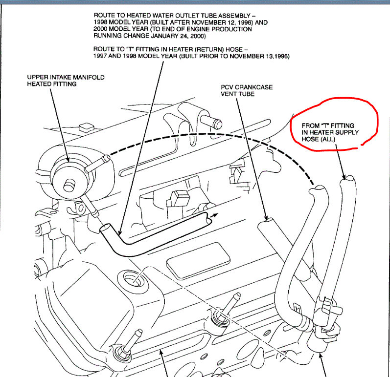

Don't worry. The part you are referring to can be replaced. As far as the heater core, chances are it was bypassed because there was a problem with the core leaking into the vehicle. I attached a picture of the routing of water lines. Do me favor. If you can upload a picture of where it is leaking, it would help me. Also, is the rusted component leaking through a rusted area or from a connection?
As far as the heater core, are there two hoses running to the firewall of the vehicle?

The part that is all rusted is the little stem part where the hose is attached to on that part that you had circled in the first pic you sent me, where I pulled the top hose off of and water was coming out of. I don't know which hose I pulled off or what the other end was attached to. I think it was one of the hoses on the heated PCV ring that goes around PCV valve. It was definitely not the right one, I am sure. As far as the Heater bypass goes the "Mechanic" that I had change my water pump said that my heater core was bad so he bypassed it, However, I did not have water on my floor board, in fact my truck was leaking a lot of green antifreeze underneath the truck. Yet my truck never got hot at all. Weird. And please know that all this basically began after taking my truck in the shop to have my entire coolant flushed out due to another of rusty looking water. It took the shop less than 5 minutes to "complete flush" and they put in gold antifreeze they said, yet all that poured out was green green.

Let me know. I wish I could see what you are dealing with. I suspect when the heater core was bypassed, they rerouted the heated PCV hoses as well and that's why they look wrong. I can tell you that the supply line that went to the heater core first went through the PCV heater then to the firewall (heater core), The return from the heater core will run back to the engine.

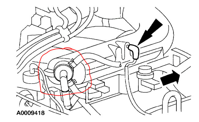

Okay, now this I guess is the part that connects to my Plenum (rear) (the round thing top left corner) that 3 hoses connect to and where I removed one and a lot of water came running out of. Now it says that 2 of those hoses connecting to it are for coolant and 1 connects from the PCV. (Is that correct?) Now what would happen if the hoses got switched and one of the coolant hoses got connected to where the PCV hose should of been connected and vise versa?

If you connect a coolant hose to where the PCV goes, coolant will enter the engine.

That is what I have been trying to figure out here and need help with. If in fact that is what happened and that guy did switch the hoses around like I thought he did and that is the reason why when I disconnected that hose (do not remember which port I took the hose off of)from that thing that is why all that water came running out of it because my engine is full of water. So what then? Do I need a new engine? What can I do or have to do to determine if that is what happened? It does not look as if I have any water in my oil at all, (it is not all milky). So please tell me what I need to do to see if my engine is now full of water and damaged or what? Please

The easiest way to check is by the oil level. If it is extremely high, then you know there is a problem. Also, water is heavier than the oil, so if you drain the motor oil, water should come out first.
