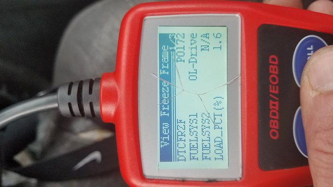

I was driving my car and it was running fine. I stopped at the store and got back in. I started it up and took off. About two miles in I noticed it was lacking power, kind of a lot but would catch and gain it back. Well about five miles after that the car just shut off out while going 65 mph up the highway. I tried starting it again and it would crank really weak as of the battery was dead, but wouldn't turn over. It sat for about two hours and when I got back to the car I tried turning it over and it started up after a little bit of hard cranking. Immediately it was shaking a little and there was a loud grinding sound. The motor is idling weak and then shuts off. The motor looked as if it was shaking really bad. But, i do not know if that was just the weak low idle. What could this be? please help me.

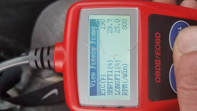

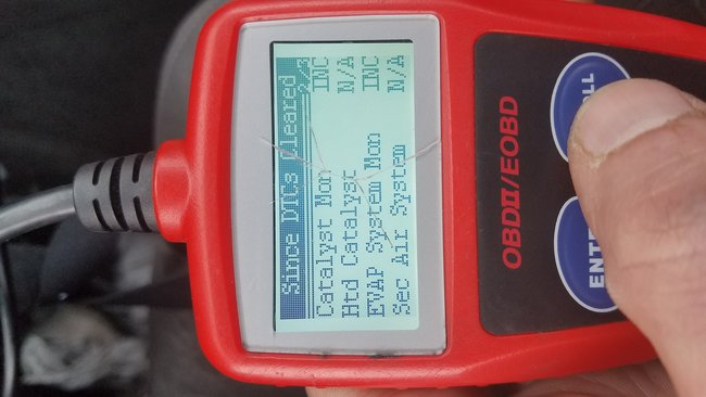

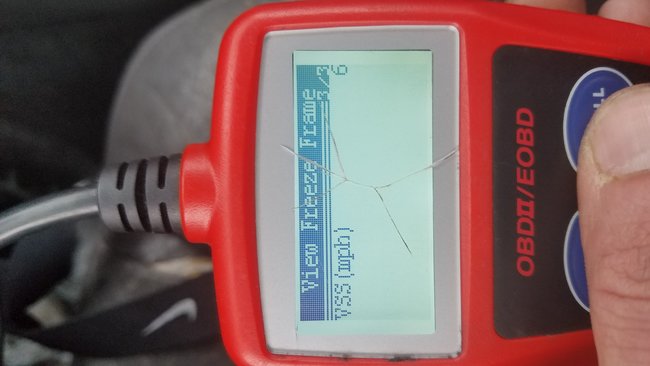

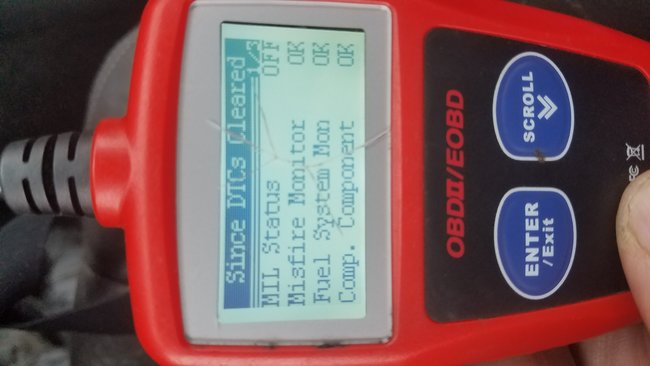

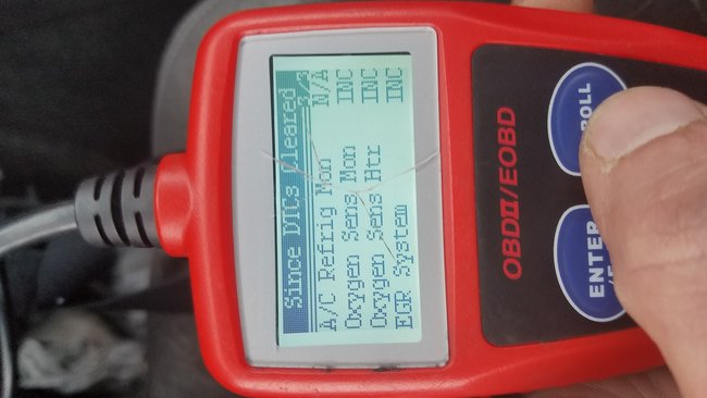

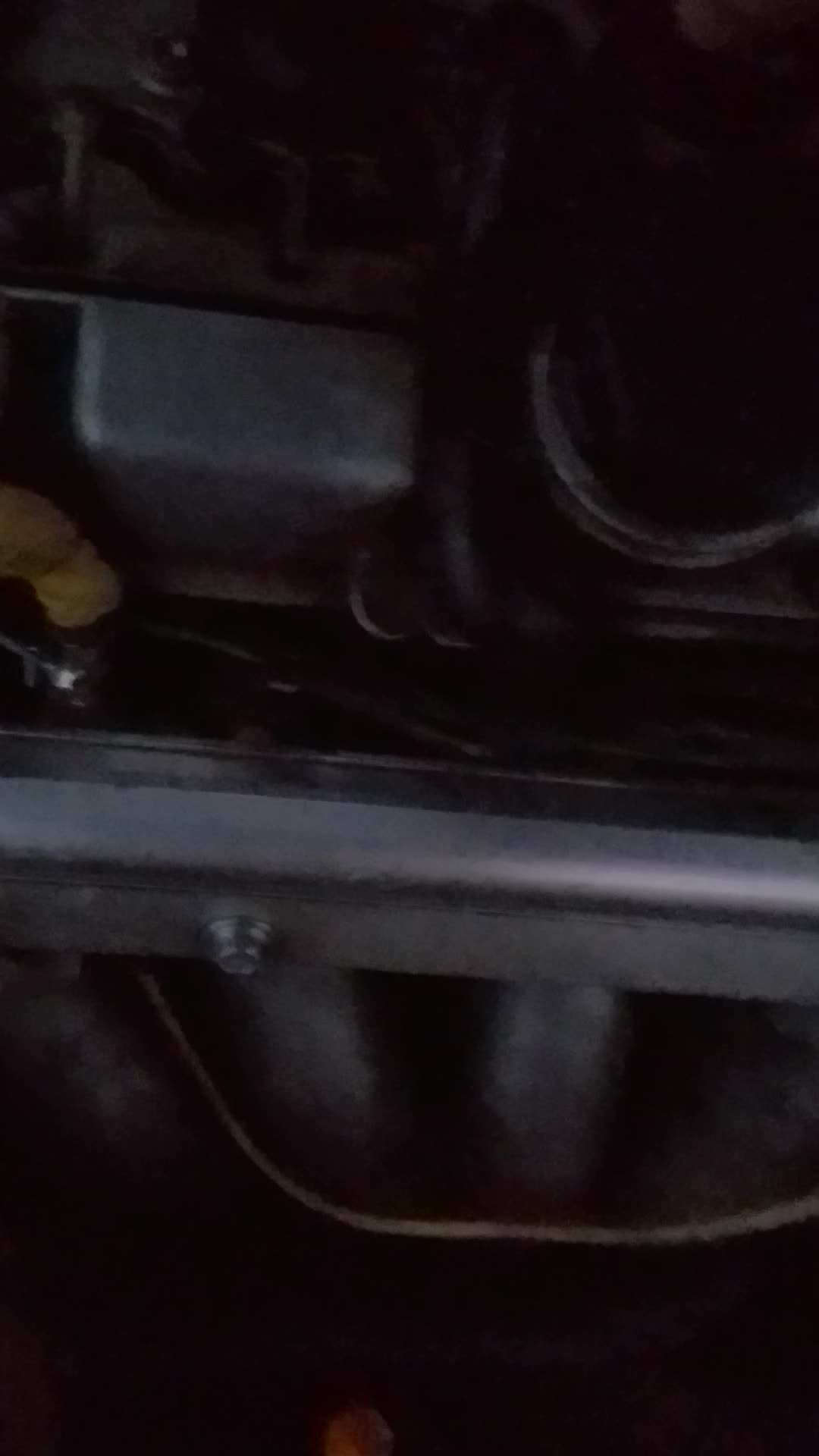

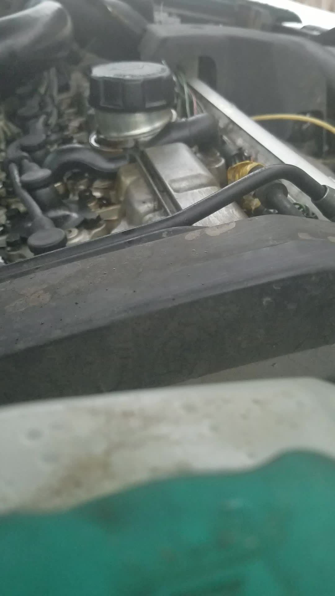

NICK JERSEY BAL
  • 5 POSTS
thanks again for your reply. No there is no check engine light on currently. when i ran the obd2 last time i got several codes indicating that i was misfiring on cylinders 2,3,4,5. i thought it was strange so i replaced all spark plugs and check engine light turned off without me having to reset it and erase codes. when i replaced the spark plugs the sound wasnt there anymore. i let the car warm up and idol on its own for about 3 minutes, after about 3 minutes the sound then started again. i pulled the spark plug wires off one by one while the engine was started and when i pulled the 3rd wire the sound almost wasnt there anymore. the pictures attached are the only thing the obd2 shows right now, no codes at all. and the videos are of how the engine sounds and when i pull the 3rd spark plug wire off.

Hello again.
On the second video is the engine running with the spark plug off or is that how the car is running/complaint? Thanks again for using 2CarPros.
