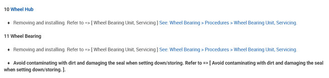

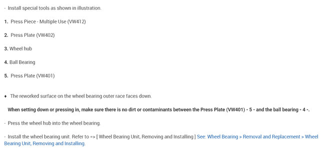

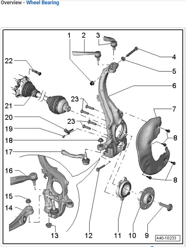

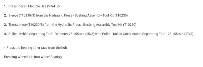

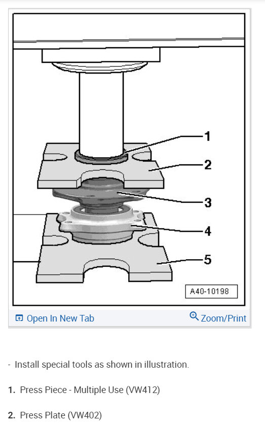

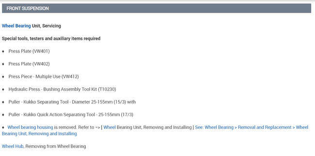

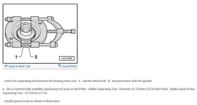

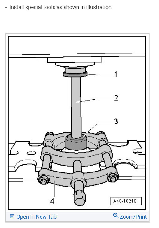

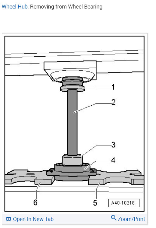

Yep, this is common when the bearing hub goes out which causes the sensor to be misaligned with the reluctor. This will give the code that the wheel speed sensor is bad, which is not the case. Here is how to change the bearing hub out which should fix the problem. The bearing will need to be pressed from the hub which an automotive machine shop can do for you, here is a video to show the process.
https://youtu.be/_FzmmBoa4Tg?si=V1GPwTDJZ2oLCa42
Check out the images (below). Please let us know how it goes.
