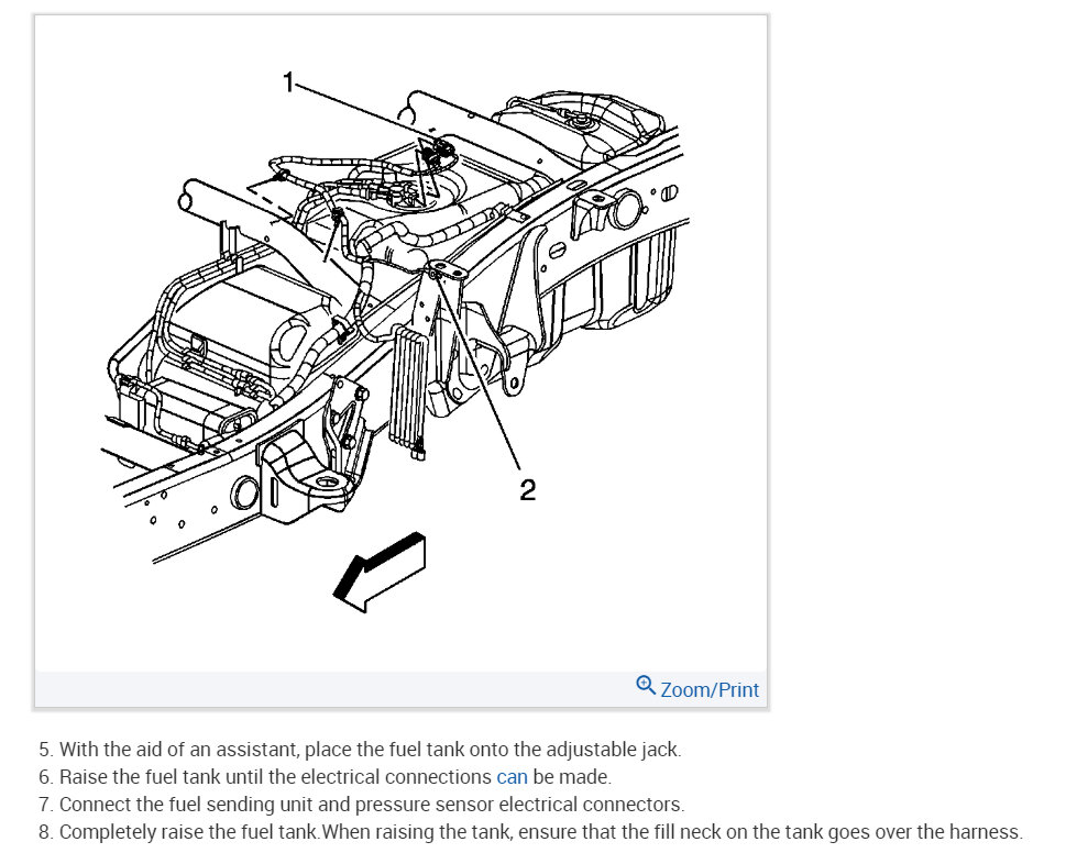

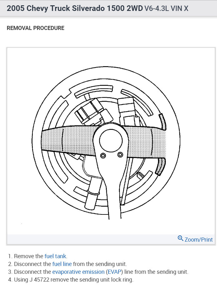

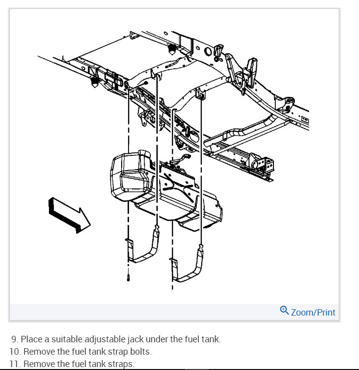

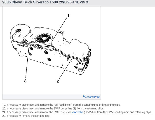

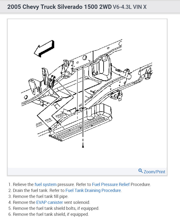

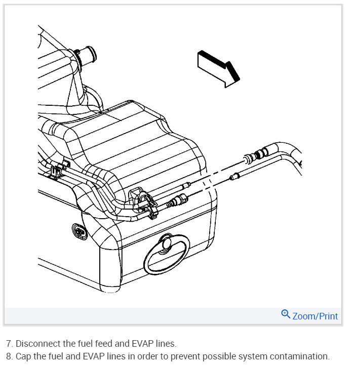

The P0171 and P0174 trouble codes on a 2003 Chevrolet Silverado indicate that both banks of the engine are running too lean. The main reason for this to happen is low fuel pressure, which is common on these trucks, here is a guide to help us confirm the issue and you can rent a fuel pressure gauge from the local auto parts store for free or cheap.
and this guide may help as well:
https://www.2carpros.com/articles/engine-has-low-power-output
Fuel pressure - 55 to 62 PSI.

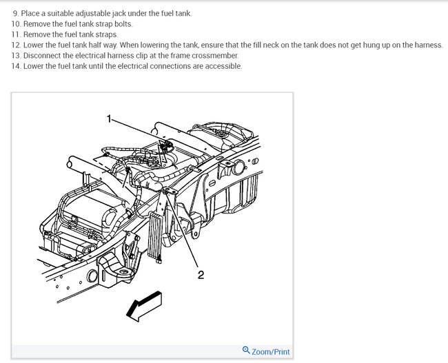

Here is how to change out the fuel pump if the pressure is low. Check out the images (below). Let us know what happens and please upload pictures or videos of the problem so we can see what's going on.
