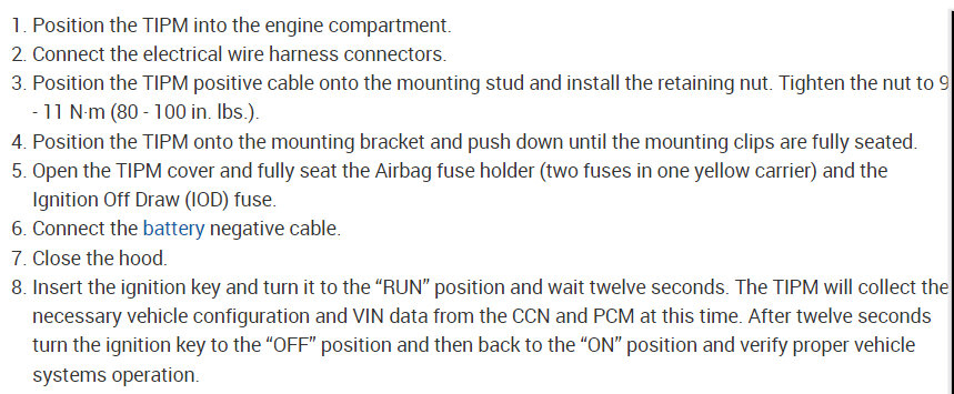

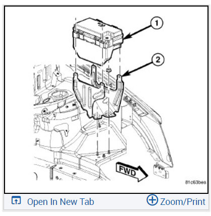

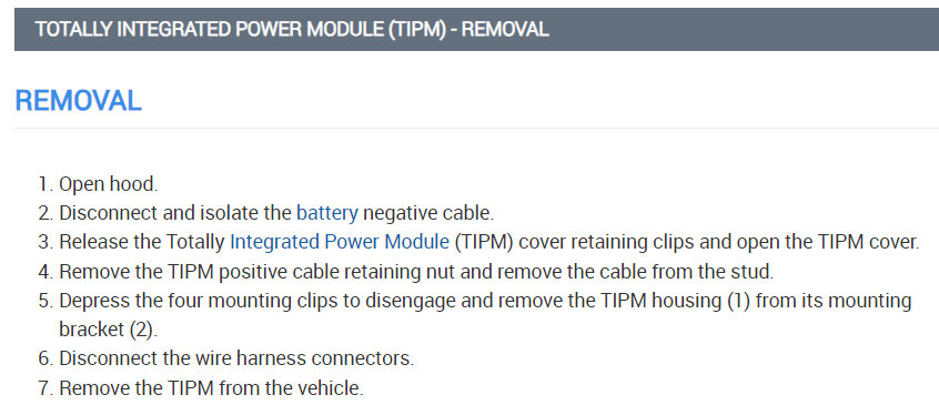

Yep, this is a common problem with these vans, the TIPM is probably going out, but I would check the battery terminals to make sure they are clean and tight. The system may have a trouble code that can help confirm the problem, you will need to do a CAN scan. You can get a CAN scanner (Controller Area Network) which will work on most cars from Amazon.
https://youtu.be/u-4syLc-ifQ
Here is how to do the TIPM replacement which I would get new from the dealer, it is easy to replace because itself learns. Check out the images (below). Please let us know what happens.

Yes, it can be related, when you say scan, was it a CAN scan? It still can be the TIPM which does not always leave a code. All of the items you have mentioned are controlled by the TIPM.

With no codes in the CAN I would lean towards the TIPM. I have seen the TIPM cause some relay strange problems which you seem to have.
