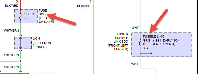

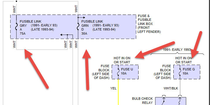

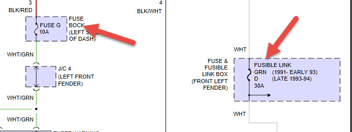

I can start the car, but I have no power inside nothing works except the headlights.
Dec 6, 2016 at 2:17 PM
HMAC300
  • 48,601 POSTS
check fuses and fusible links in pictures then check remaining fuses.
