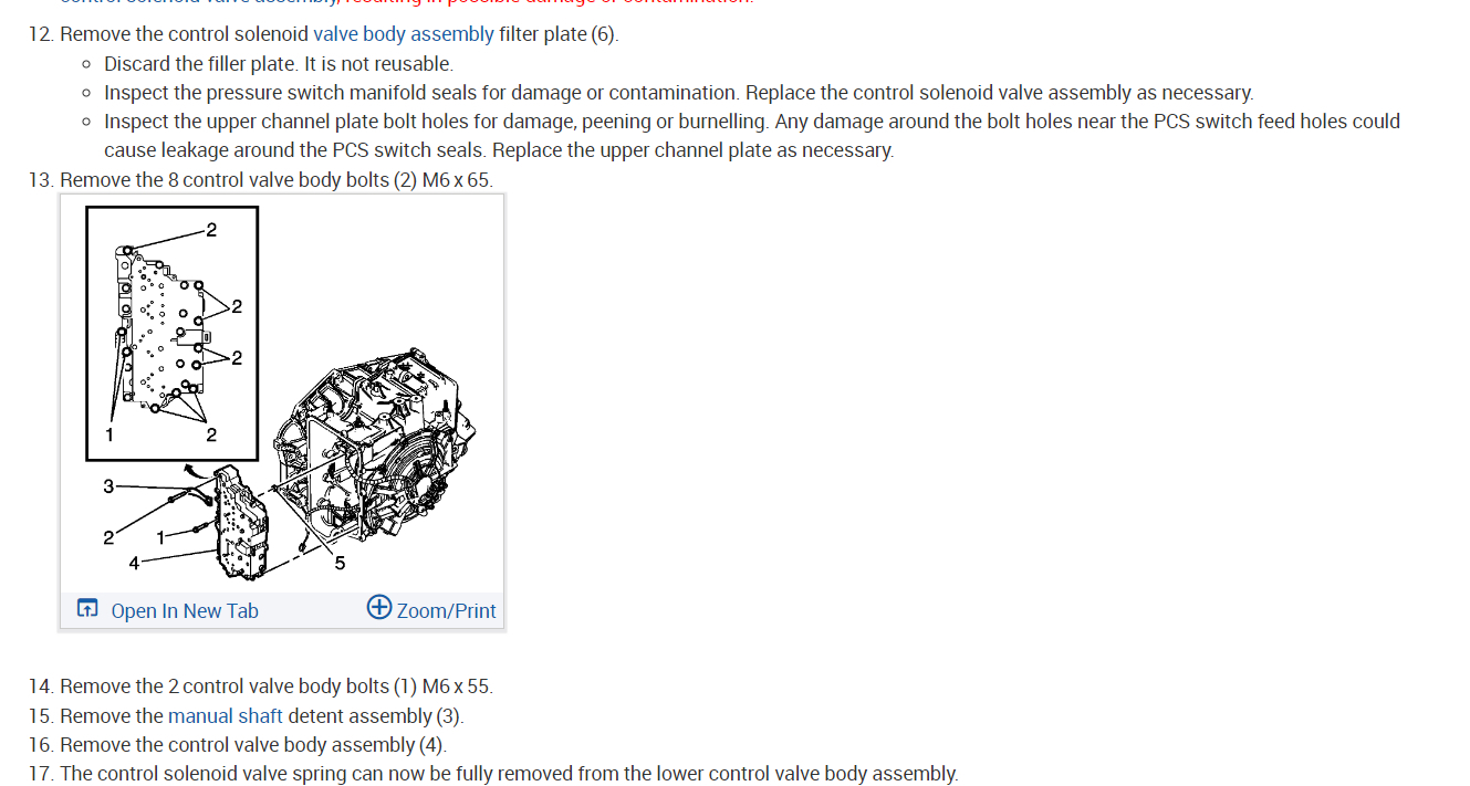

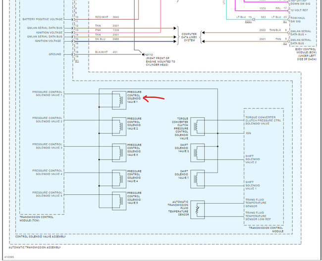

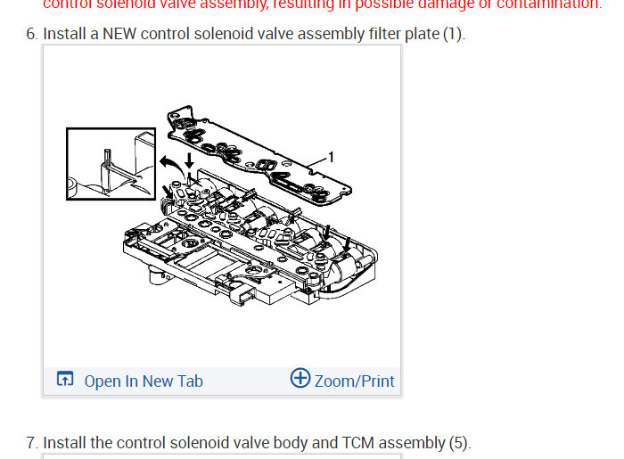

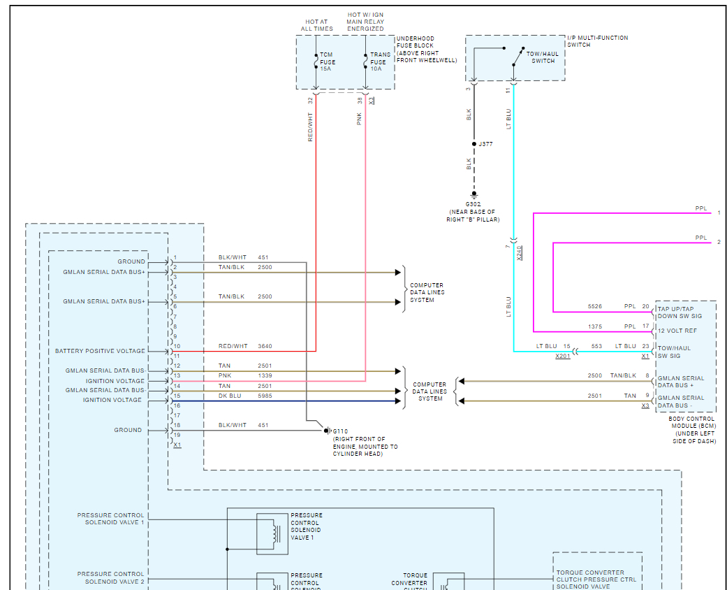

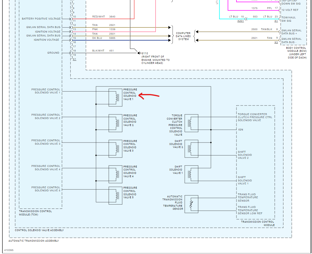

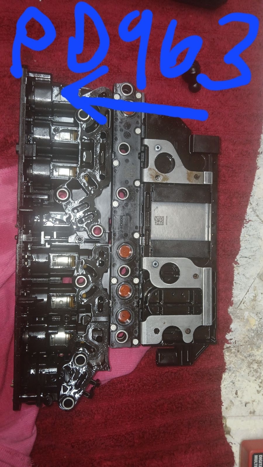

Hello, we have flushed and changed solenoids, and it still continues to slip around 3rd gear and as it gets hotter is slips or does not shift even sooner like in 2nd gear, we took it to AutoZone to get any codes that come out and we got one code, it is P0963, High voltage the solenoid is working when I test it but that code is still coming out, what is the easiest way and fastest to fix this, also could this be why the car is slipping or not going into gear, this is the picture I have of the solenoids, does the specific solenoid that the arrow is pointing to have independent wiring or its own wiring to troubleshoot properly, the electrical schematic is integrated into the whole assembly. How do I trouble shoot P0963 on this particular assembly?
Sep 27, 2024 at 1:05 PM
  • 54,832 POSTS

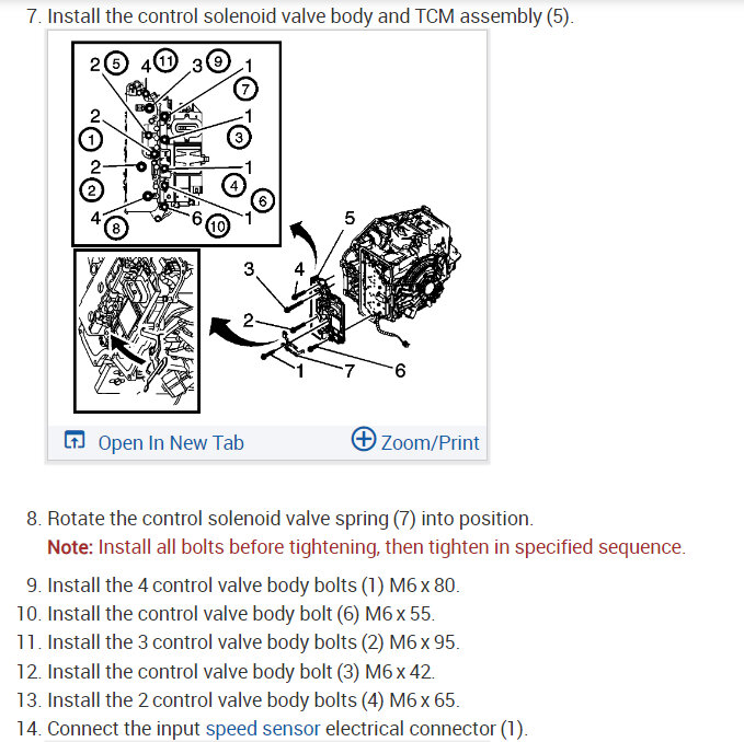

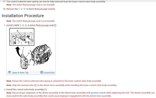

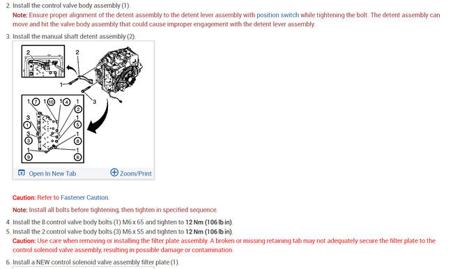

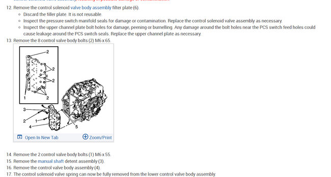

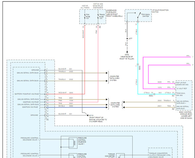

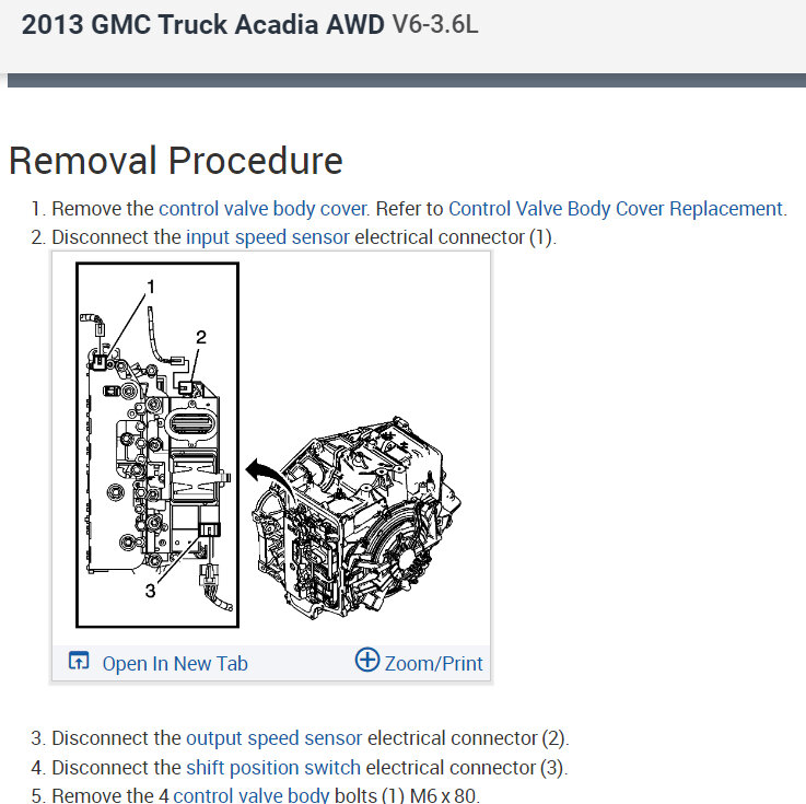

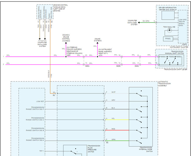

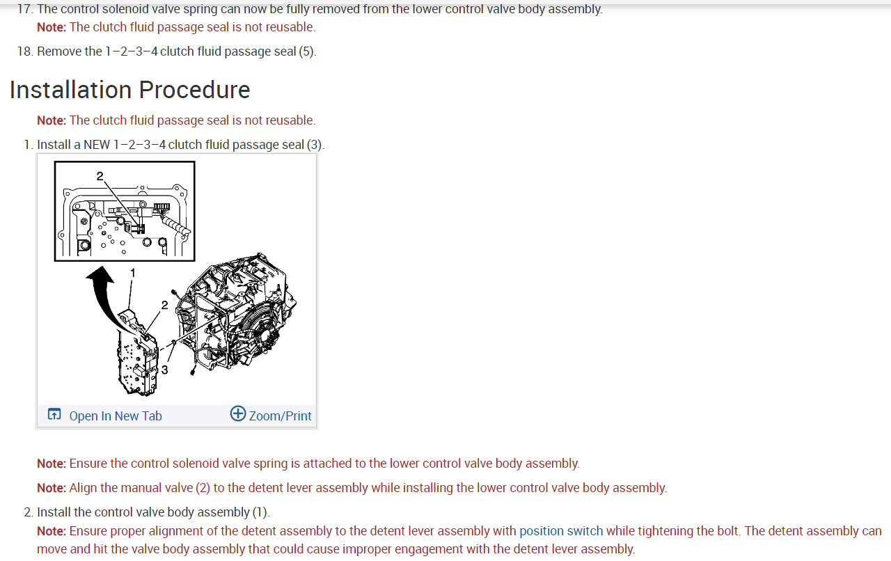

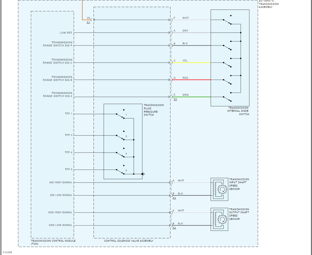

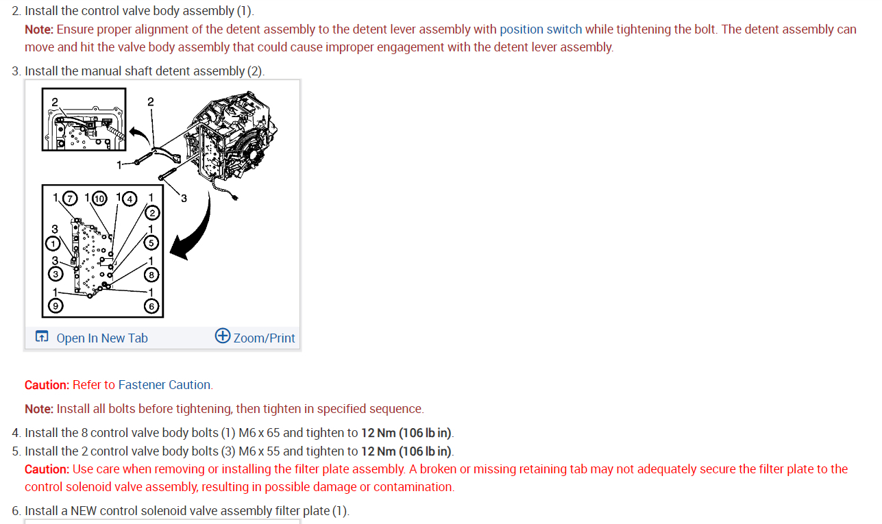

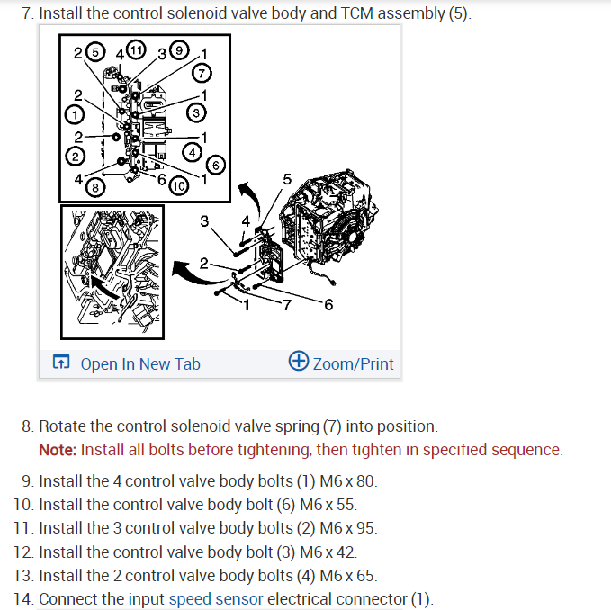

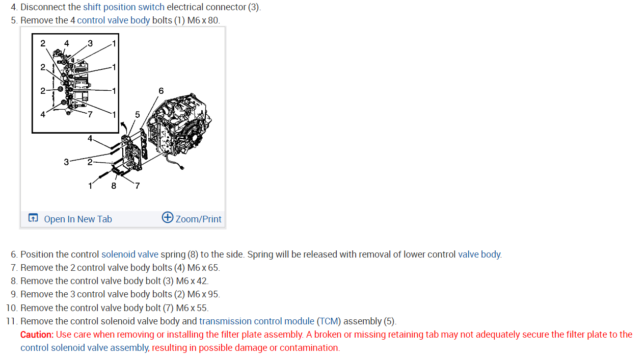

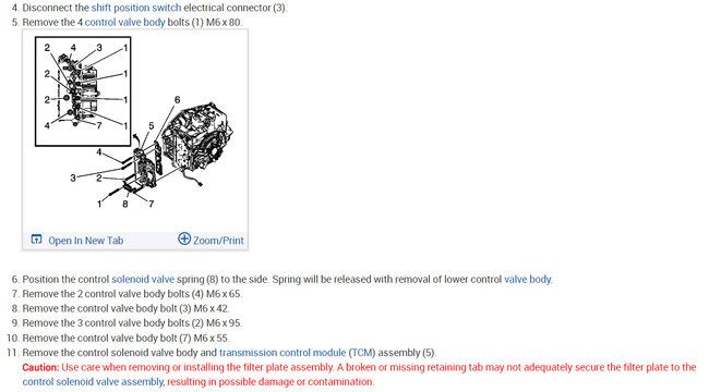

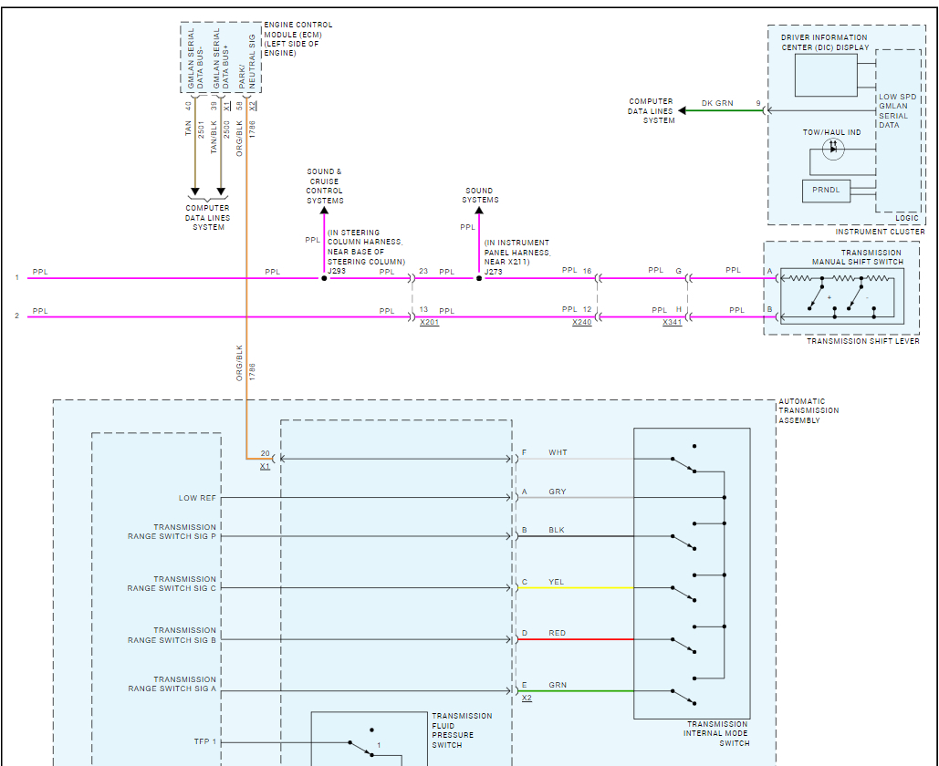

The error code P0963 for a 2013 GMC Acadia indicates a problem with the "Pressure Control Solenoid 'A' Control Circuit High." So this will cause the transmission to slip or the pressure pump is going bad inside the transmission, there is a pressure port in the side of the case that you can plug a gauge into or you can swap out the pressure solenoid. Here is the wiring diagrams so you can see how the system works and which solenoid does what, I marked the #1 solenoid. Here is the correct way to remove and install the valve body plate in case you need it. Check out the images (below). Please let us know what happens.

Okay, thank you so much, pump is working because we used it to flush the oil out from the outlet line, is it possible that the place where I buy the whole TCM assembly they can pre-program the TCM so I can just plug and play?

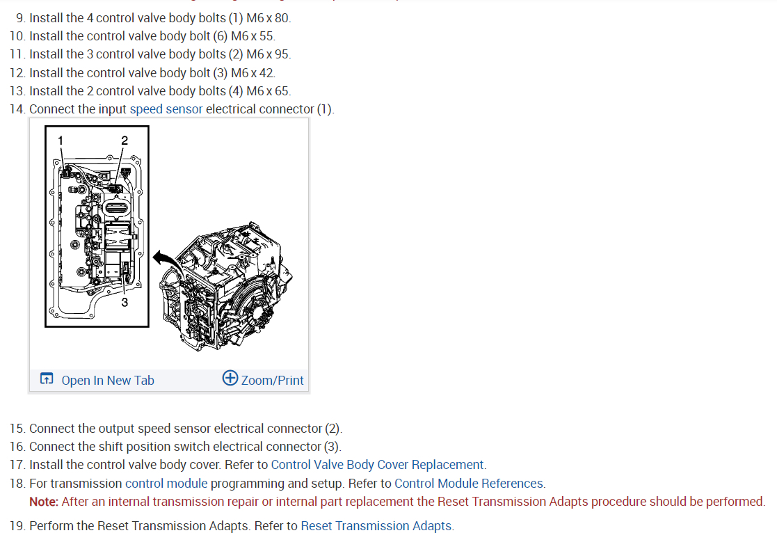

Ken, another question, after removing the TCM assembly and putting a new one or even the old one back do I need to drive the car to relearn the system, because I noticed that it drives and all but continues to slip.
Sep 29, 2024 at 11:02 PM
  • 54,832 POSTS
Yep, you may have a broken clutch hub or the clutch discs are worn out. Was the fluid burnt? If so then this can be the problem. Also, if the transmission filter O ring is leaking the fluid will have air in it and make the transmission slip.

The error code P0963 for a 2013 GMC Acadia indicates a problem with the "Pressure Control Solenoid 'A' Control Circuit High." So this code can be because the front fluid pressure pump is going out. It sounds like you need a rebuild.
