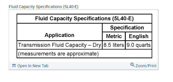

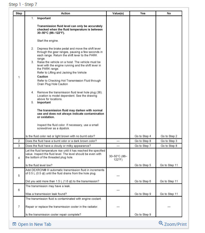

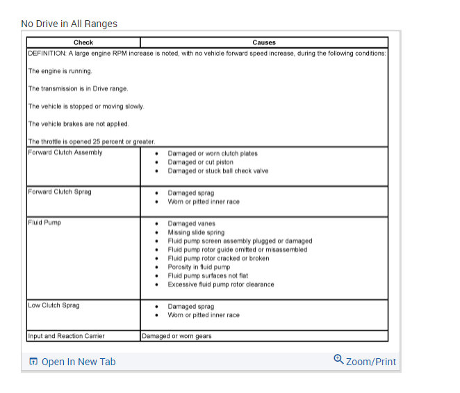

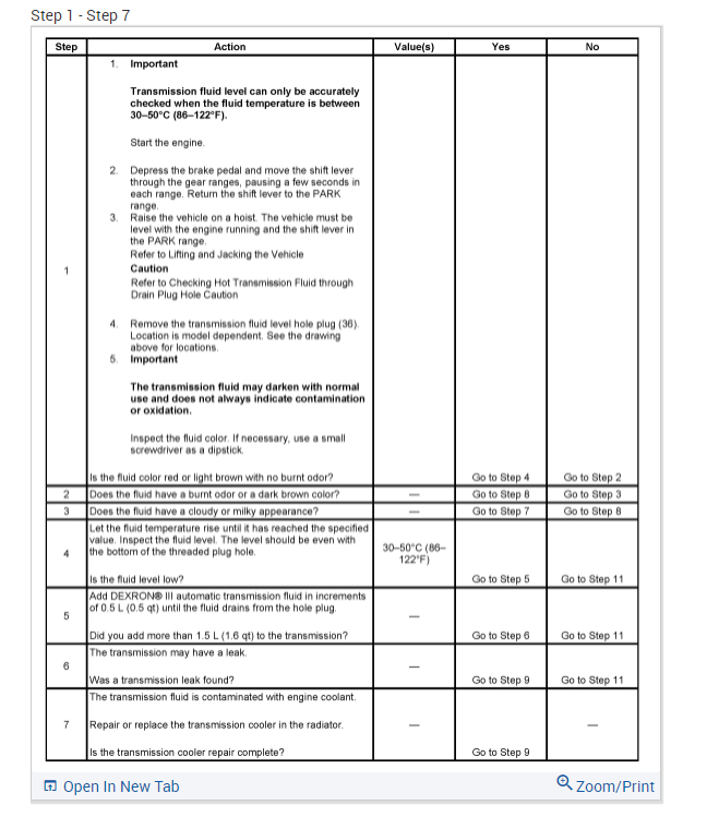

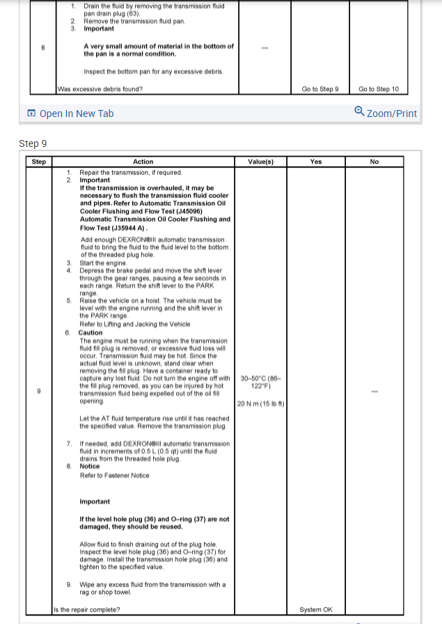

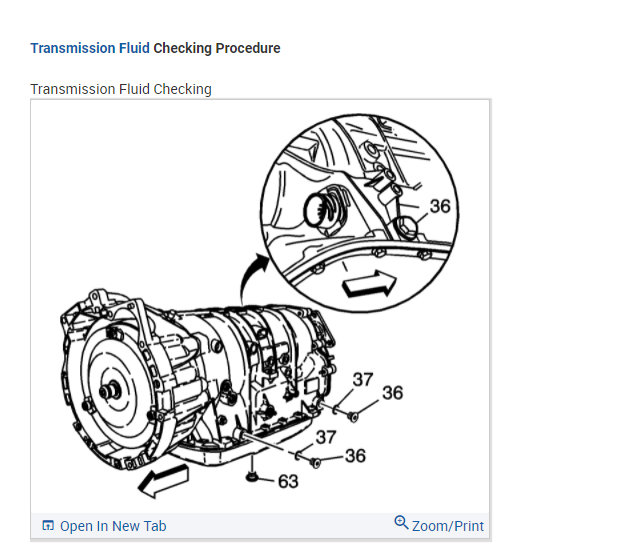

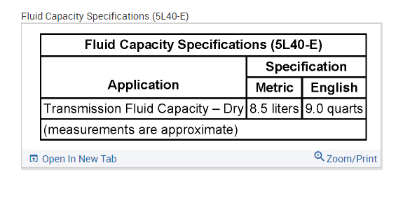

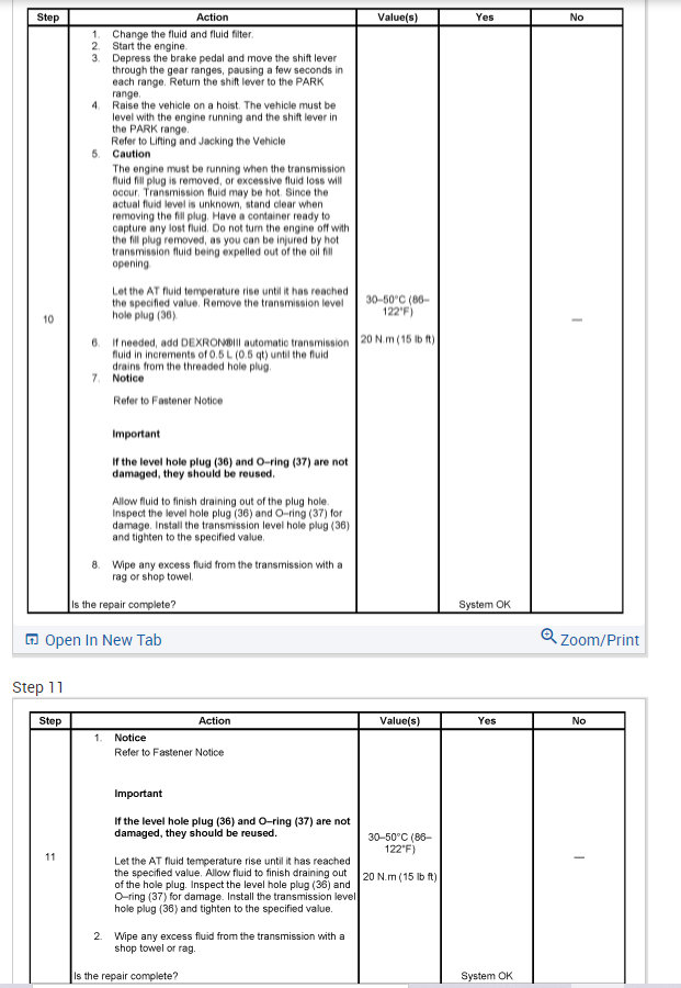

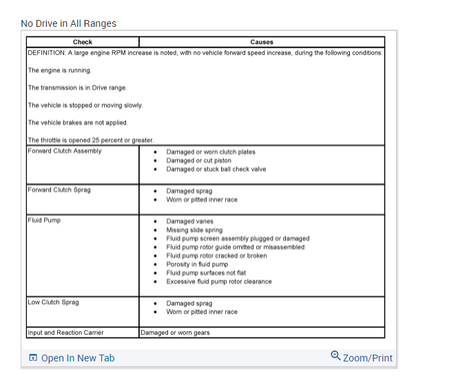

I attached the procedure for changing the fluid for you below. It is a little involved but follow the instructions and you can do it yourself.
I also attached the amount of fluid required when you change it and the flow chart for no moving in any gear.
