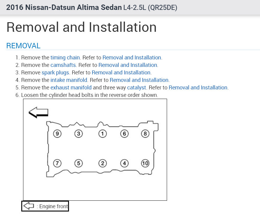

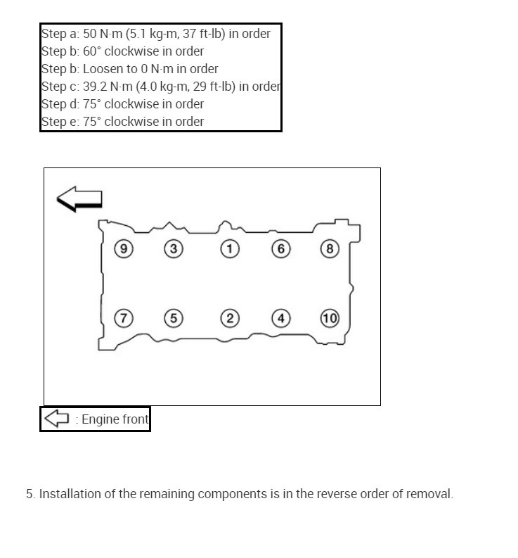

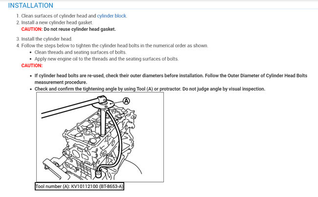

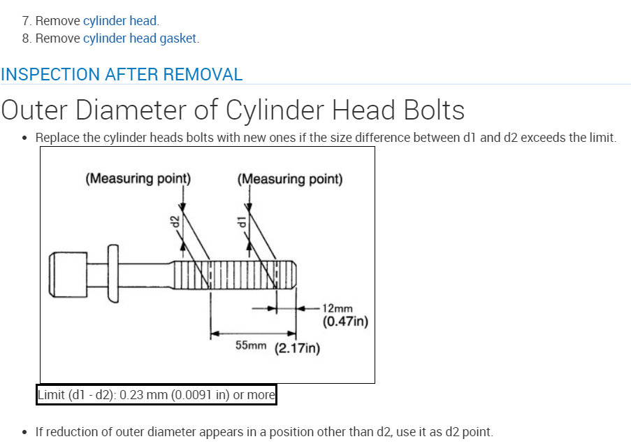

Changing head gasket on my car and I need the torque specs?
Jul 31, 2022 at 7:35 AM
  • 55,433 POSTS
Okay, these are done a little differently than usual. They must be done in order, and you will be using an angle torque wrench. What this video at about 15:40 it will show you what I am talking about. Also, here are the exact instructions in the diagrams below for your car:
